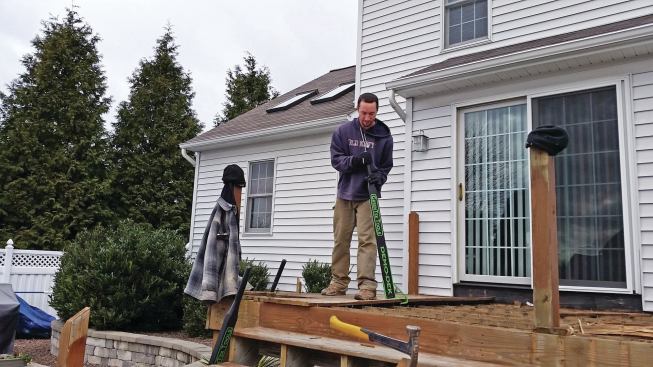

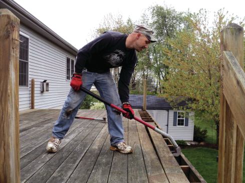

Once upon a time, we did all our disassembly with digging irons and pry bars. Fortunately, now there is a wide assortment of decking-removal tools that can pop up deck boards with relative ease. While the tools look similar, our crew members each seem to have a preference, and each deck requires a slightly different plan of attack. So we stock several different kinds and select the best one for a particular situation.

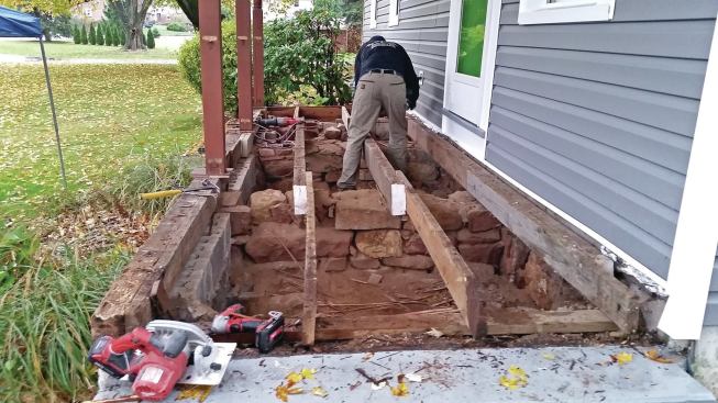

Systematic Deck Removal

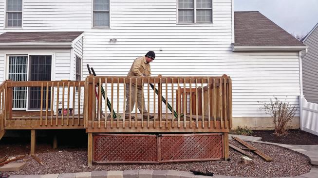

We try to remove as much of the deck as we can and reduce the deck’s weight as quickly as possible, while retaining accessibility and support for the structure we are working on and around. Generally, this means removing the railings first and cutting them into large sections (we usually cut rails at the post) that will stack well. Then we strip up the decking a piece at a time, leaving the steps and framing for last.

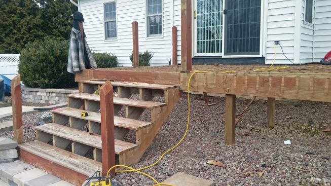

We remove the floor joists one at a time, often retaining a few temporarily to keep a beam in place. If a beam is too large to remove all at once, we cut it into smaller sections. We leave stairs up until we no longer need them, occasionally adding temporary supports to hold up posts while we remove beams and stair stringers.
Generally, the last item we work on is the old deck ledger, which almost always needs to be replaced. It’s much easier to safely get ladders into place to remove any bolts and inspect and prep the house wall once everything else is out of the way.

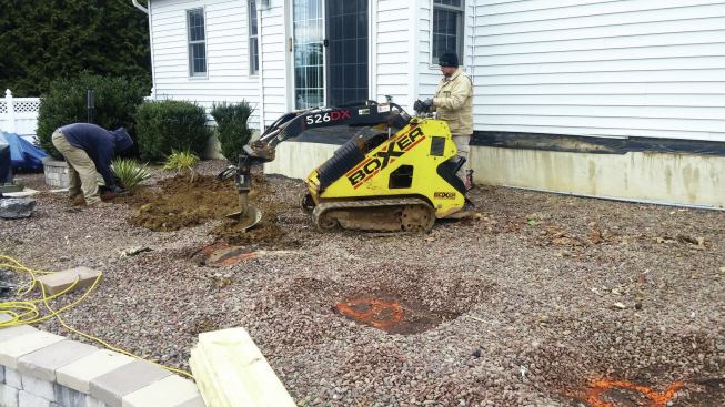

Lots of builders simply order a 40-yard trash bin, park it out front, and let the trash hauler worry about the debris once it has been filled up. But in our area, it’s often difficult to place a large trash bin so that it’s near the site of the actual demolition. Rental costs continue to rise, too, and additional permitting requirements and client and neighbor concerns have caused us to rethink that strategy. Now, we haul all of our own debris off-site to a trash container that resides permanently at our shop. We rent the bin from a small local carrier on a monthly basis, and simply pay disposal and hauling fees as we incur them.

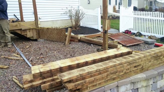

Wherever the truck or trash container is parked, old deck pieces need to be carried by hand away from the backyard where the deck is located. To make that path from deck to destination as short and easy-to-maneuver as possible, we eliminate obstacles by removing patio furniture and other items, and temporarily prop open any gates.
Often, we put down sheets of OSB or tarps to protect patios or lawns, and to make collecting small debris easier. Rather than dropping smaller parts onto the ground, and then picking them back up moments later as we clean up the site, we try to collect them in trash cans as we work. For larger items that will require extra hands to move, we make sure the pieces are staged in a way that will allow them to be safely grabbed, either on solid sawhorses or sitting slightly elevated on blocking.

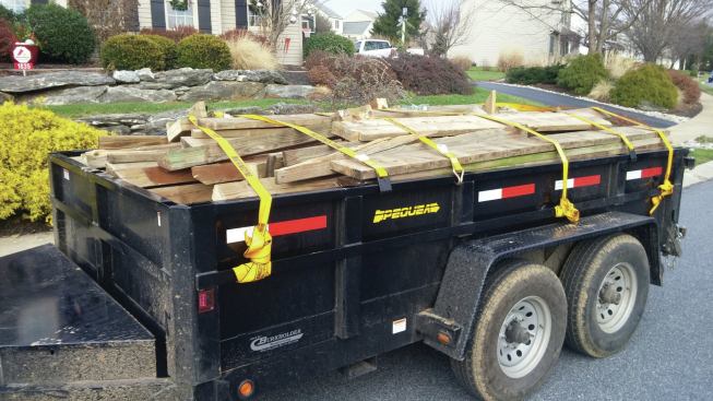

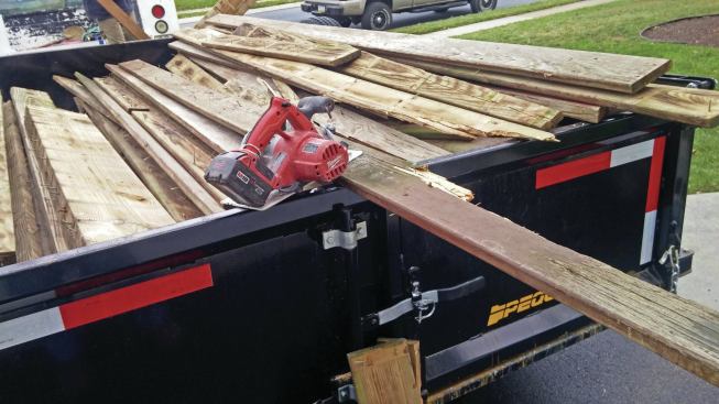

To transport the old deck debris back to our trash container, we use a combination of standard pickup trucks with open utility beds and ladder racks, and trailers (both open and dumping). We leave the small pieces in their trash cans, and load the filled cans onto a truck, which makes it easier to dispose of the debris back at our shop. Longer decking is usually strapped down onto a ladder rack. Given the weight, we prefer to use a trailer for the joists, posts, and beams. To help hold loads together, we often strap railings down onto the top.
While it may be mundane work, carefully stacking the materials properly into the trucks and trailers to maximize use of space and keep loose items secure is critical—once everything is loaded and properly strapped down, we don’t want anything shifting or coming loose as we travel.
We use large ratchet straps to provide the primary security for the deck debris, and smaller ratchet straps to secure secondary areas (like holding a particularly long stack of decking all together). We have plenty of bungee cords on hand, too, which we use as needed for loose pieces, such as balusters, that need some extra security.
