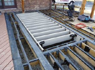

My next concern was the structural integrity of the hatch. I felt that a wood structure wouldn’t stand up to flexing. Also, I wanted the decking on top of the hatch to blend with the rest of the deck, which meant that clearances had to be kept to a minimum. But the dimensions of a wood-framed hatch would vary seasonally, requiring large clearances that would be hard to mask.
A metal frame would solve both of those problems, so I decided to use 9 1/4-inch SteelDeck Framing material (Xccent Decking; 800/933-4748, xccentdecking.com). It would make a stiff frame that wouldn’t change size with the humidity, and it could be cut with a toothed steel-cutting blade in a circular saw (Figure 3).
Figure 3. Steel joists make a frame that doesn’t change dimension with the seasons.

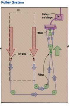

The major problem with this system was that the confined space in which the arms had to fit meant they’d be nearly parallel to the hatch at the outset. The smaller the angle, the greater the force required to lift the hatch. In the final design, the lift-arm angle was approximately 9 degrees from horizontal, which would require an initial pull of roughly 8,700 pounds to lift the 1,200-pound hatch.

I know I just said that 8,700 pounds of pulling power was needed to lift the hatch, and this winch provides less than half that. I overcame the difference with a compound pulley system that lowered the pulling force at the winch to approximately 1,740 pounds (Figure 7).
Figure 7. Pulleys control the direction of pull and provide the mechanical advantage that enables the winch to raise the hatch.  Photo credit: Chuck Lockhart
