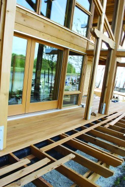

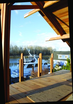

It rains eight months of the year in my location, so standing and pooling water and moisture traps are serious business (Figure 2). A very important aspect of deck longevity is the attachment at the house. It’s crucial that the integrity of the home be maintained by properly wrapping and flashing this area and by leaving an airspace or drainage plane, if possible. I’m aware of two products for creating a space at this connection: the Deck Ledger Spacer by Go Ahead Deck Me (866/583-0939, goaheaddeckme.com) and the Deck2Wall spacer by Decks Unlimited (888/577-2237, deck2wallspacer.com).

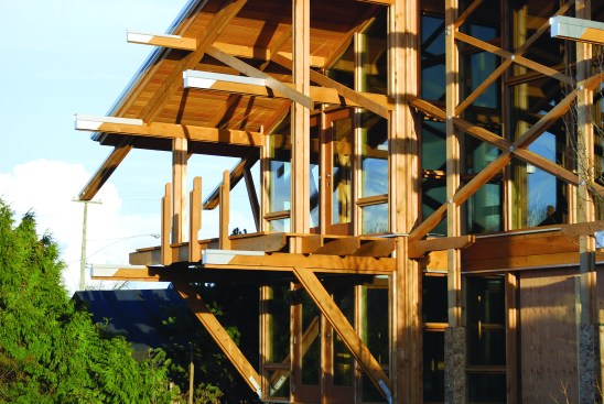

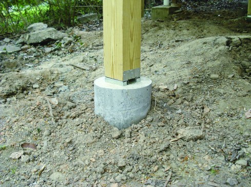

A few simple details will help prevent water from soaking in. Minimize horizontal surface areas; for example, chamfer the tops of rails and posts (Figure 3) and use 2-bys on edge instead of on the flat in your designs. Also, avoid having end grain meet a horizontal surface whenever possible and seal the end grain thoroughly. For this, I use two liberal coats of Timber Pro UV (Timber Pro Coatings; 888/888-6095, timberprocoatings.com). Another good idea is to use post bases with stand-offs, as I find post bottoms are vulnerable and one of the first places to go (Figure 4). Finally, it isn’t always possible, but wherever two pieces meet parallel, it’s nice to have at least a small airspace in between for drainage and drying.

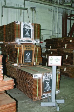

Buying environmentally certified lumber is one way to ensure that your wood was harvested in a sustainable manner. Unfortunately, certified lumber in decking materials may be hard, if not impossible, to come by in some areas. If you can find it, FSC-certified lumber is the LEED standard (Figure 5, page 58). The FSC (Forest Stewardship Council, fsc.org) requires strict chain-of-custody records to document the lumber’s source. Another organization that certifies lumber is SFI (Sustainable Forestry Initiative, sfiprogram.org).

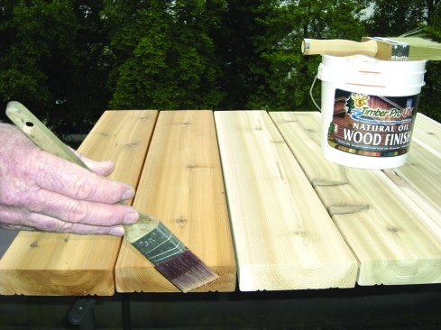

Keeping water and sun from damaging wood decking is important to its longevity. Although opinions vary, I believe it’s common sense that water-based finishes are greener than oil-based ones. I prefer Timber Pro UV (Figure 6). It is made with natural oils and is considered green and sustainable enough that its use can generate two to three LEED credits.
Our second biggest battle (the first being against moisture) is against the sun and its constant barrage of UV rays attacking our decks. Deck stains without some pigment in them are not nearly as effective at blocking UV and don’t last as long. Semi-transparent stains are a good choice for a number of reasons: They can effectively block UV rays, they allow you to see the natural beauty of the wood, and they usually don’t need to be reapplied as often as a transparent stain.
