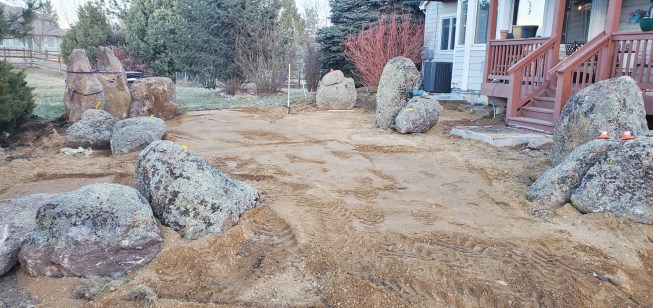

Workers began the project by laying the gas supply line in a 30-inch-deep trench, then placing boulders in their proper locations on the site of the future flagstone patio.
Next, the site was prepped for the concrete slab that would provide a base for the patio. 24 cubic yards of concrete were required to pour the slab.
After demo was complete, we excavated a 30-inch-deep trench from the front yard at the gas meter all the way down the side of the house through the home’s existing landscaping (which we had to maintain). From there, we continued our excavation under a fence, through the backyard, and around to the planned location for the new fire feature. Spanning nearly 150 feet, our trench managed to disturb the entire property, as we encountered sprinkler lines and drain piping and left mounds of dirt around the yard, all to bury a 1-inch-diameter yellow underground polyethylene gas pipe at the right depth.

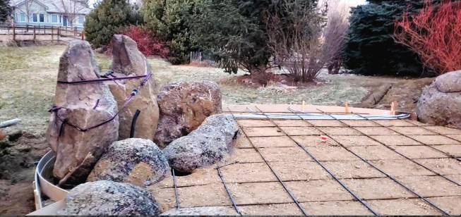

The flaming boulders were one part of a much larger project that included a flagstone patio with stone sourced from around the world, a deck, a porch cover, and an outdoor kitchen. We began by strategically placing 42 tons of local moss-covered boulders—selected to complement the size and style of the planned fire feature—at various points in and around the patio footprint. After all the boulders were arranged in the proper locations, we framed the patio area encapsulating the boulders into what would be a concrete base for the stone veneer. Then we locked the boulders into position with 24 cubic yards of reinforced concrete to ensure they’d never move and would forever be a part of the flagstone patio.
The two boulders we used for the fire feature weighed nearly 4 tons each, with the tallest one being nearly 7 feet high. Initially, we had planned to use a crane to set the boulders in place, but it turned out to be much more economical to rent a four-wheel-drive forklift with an extendable boom to manipulate the boulders into position and erect them.

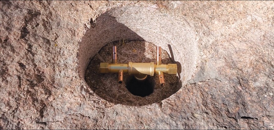

To house the burner assemblies needed to create the flames, the author carved 8-inch-deep recesses into the tops of the boulders with a 10-inch-diameter core bit.
Then he switched to a smaller core bit to drill 2-inch-diameter holes down through the recess to connect to holes drilled horizontally through the backs of the boulders for the gas lines.

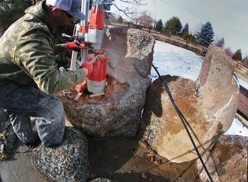

To make a connection to the gas line that we had buried in the yard, we had to bore holes through the boulders. I first used a 10-inch-diameter diamond-tipped coring bit mounted in a Hilti core drill to remove 8 inches from the top of the boulders. Custom burners would later be housed in the holes, which we would then fill with lava rocks. Besides filling the holes to a level point on top of the boulders and hiding the burners, the lava rocks would help disperse gas to create more combustible area for the fire.

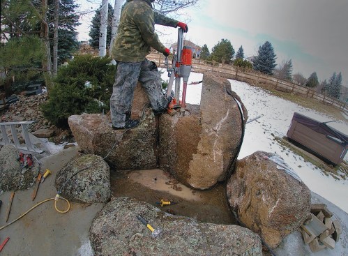

I began with a handheld version of the drill, but quickly found the tool too powerful for this application. So I mounted the drill’s stand directly to the boulder tops, anchoring the stand’s feet to the stone with 10-inch-long wedge bolts (with 4 inches of each bolt embedded in the stone) to keep the high-torque machine stationary while drilling accurately.
After I removed the top 8 inches of stone for the burners, I switched to a 2-inch-diameter bit to drill an additional 24 inches down into the stone. Because the boulders were encapsulated in concrete, we couldn’t drill their full depth, so I then mounted the drill to the back of each boulder to drill a 90-degree connecting hole where piping could be connected for gas service.

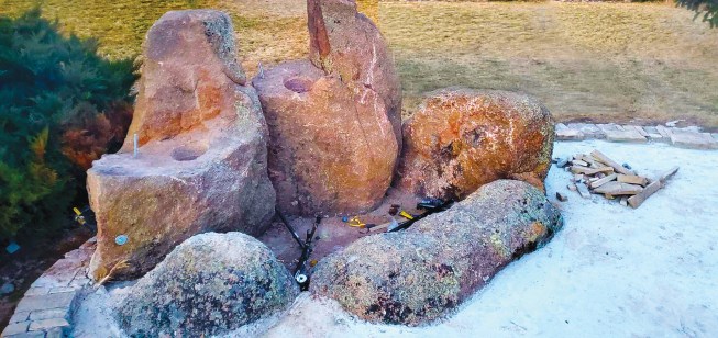

Along with the burners installed in the recesses drilled into two boulders, the design also featured two ground-level burners in front of the boulders.

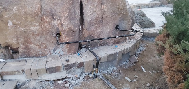

Gas is supplied to the burners via black steel supply lines that run through 2-inch-diameter holes drilled through the backs of the boulders.
These 2-inch-diameter holes house 1/2-inch-diameter black steel piping, which we coated with Diamond Vogel two-part epoxy paint to create a permanent weather barrier so the steel pipe wouldn’t rust in the future. The extra clearance around the pipe through the rocks allows for ample air draw so the flames can burn at maximum efficiency.
Each assembled brass burner is rated at 50,000 Btu, and will be covered by porous lava rock.
We used parts from Warming Trends to construct the burners. To create nozzles and multiple burn points, we threaded 1/8-inch-diameter pipe nipples into larger, 1/2-inch-diameter threaded brass pipe in a tee shape. The upper burners are rated at 50,000 Btu each, while each of the two lower burners is rated at 60,000 Btu, for a 220,000 Btu maximum burn potential. Actual use is less than half of that.

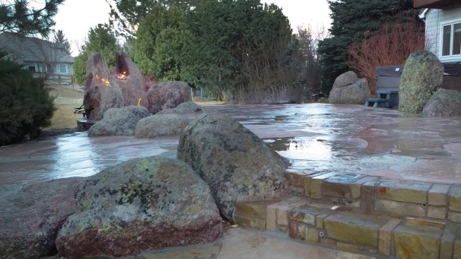

The fire feature is the cornerstone of a larger patio project.

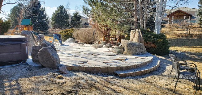

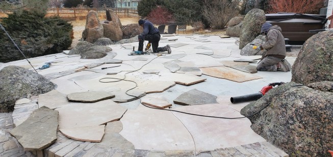

With the burners installed, workers completed the project by setting multicolored flagstones in mortar on top of the steel-reinforced concrete slab.

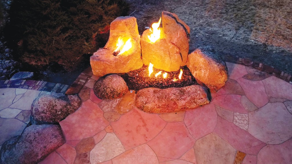

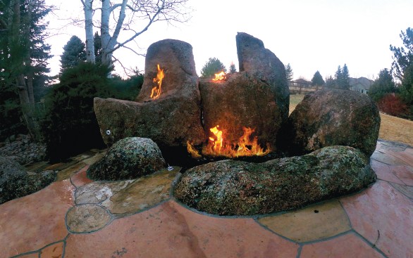

The flaming boulders are meant to be an artistic touch and visual pyrotechnic display, but not necessarily a source of heat.
t/sdcard/DCIM/100GOPRO/GOPR0169
Even so, the bottom chambers where the burners are located utilize the rocks as an infrared heat reflector, creating an elongated bed of warming flames from below.
I took it as a personal challenge that the pipe work for these features would remain unseen. One of my goals was for anyone who witnessed this project to wonder how it worked. Thanks to the literal maze of piping through the boulders, the result achieved everything I hoped for and more. ❖
