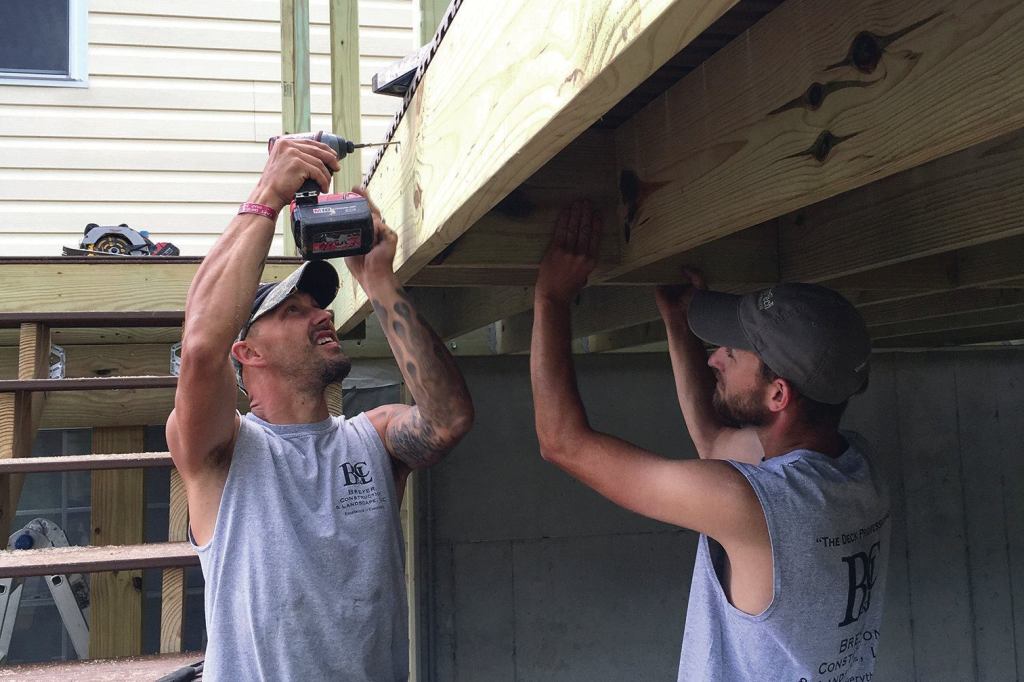

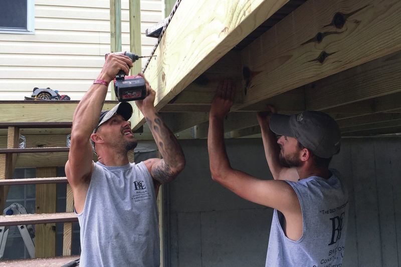

Blocking Is Key
One of our rules of thumb is to always add blocking to every rail post. We generally install any pressure-treated rail posts and basic blocking while we are framing, securing everything just with galvanized nails shot in with a pneumatic gun. This is fast and lets us place the rail posts where they belong.
Once the primary structure is together and we have turned our attention to the railing, we add more blocking as needed, filling in where it was missed during framing, or where after review we have decided that a specific post needs additional support.
If the nail gun has been put away, we may use a few deck screws to hold the new blocking in place. Like the nails, these aren’t structural fasteners, but rather a temporary or partial connection detail. However, sometimes we will put a few screws into a connection that has already been secured with nails (which are subject to withdraw), simply to pull the framing and blocking members tightly together.
Outside corners. Even on a corner where you can get a positive connection on two sides between the post and the framing, additional blocking is essential. Having fasteners driven into a post from three sides rather than two is what really helps keep the connection strong over the long-term.
We use engineered lag options such as FastenMaster’s HeadLoks and LedgerLoks (fastenmaster.com) or Simpson’s SDWS timber screws (strongtie.com) to secure guard posts to the blocking and framing. Unlike with a ledger, where we try to remain consistent per the fastener manufacturer’s specs, we’re not afraid to mix fastener styles as long as the resulting connection is secure and the inspector doesn’t have an issue with our approach.
Intermediate posts. On long side rails, guard posts are typically attached to a single rim joist. Here—where several people could potentially lean against a railing that is often supported by only a single mid-span post—is where leverage against a guard post is often the greatest, so we not only add blocking between the two outside joists, but also carry the blocking back an additional joist bay. This helps support the guard post and railing by creating additional rigidity, and it limits rotation of the rim joist at the ledger connection as well. We have seen many old decks with rim joists that are all but disconnected from the framing because of the leverage exerted on them by occupants leaning against the railings.
At the ledger. The guard posts closest to the house are another problem area. Generally, these are installed in the corners of the deck’s framing, but they’re often spaced between 1 inch and 3 inches away from the ledger to allow room for the post sleeves and skirts that are used to dress up the posts. As a result, these corner posts are often secured only to the rim joist. Meanwhile, a person leaning against a corner post creates tremendous leverage that can pry the rim away from the ledger and weaken this critical framing connection. So, in addition to installing blocking between joists, we try to fill the small gap between the post and the ledger with additional blocking.
Angles. We have found that the framing at angled corners often pulls apart over time as the wood dries out and the framing nails start to withdraw. Add a little leverage from people leaning on the guard posts, and these connections can become compromised. So we make sure to reinforce these corners with blocking, driving the fasteners through the framing into the blocking from several different directions for triangulated support.
