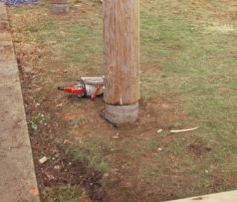

Regardless of the size of the footing where it bears on the ground, the top of the concrete – which I call a pedestal – needs to be 1 inch to 2 inches smaller than the bottom of the log post. This provides a drip-edge around the bottom of the log, helping to keep water from running underneath the bottom of the posts. To prevent water splashing onto the base of the log or wicking up from the ground, the top of the pedestal should be at least 6 inches
above grade (Figure 1).
Figure 1. Log posts are vulnerable to rot from water wicking up the end grain. Sizing the portion of the footing that's above grade to be 2 inches smaller than the post provides a drip-edge. Keep the post at least 6 inches above grade to minimize the effect of rain splashing upward.
With typical, smaller posts such as 4x4s or 6x6s, the post-base hardware allows for some adjustment. In the case of logs, where the log is larger than the pedestal and you want to maintain an even overhang, it’s more important than usual to have accurately placed the footings.

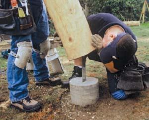

To form a hold-down for the post, I embed a Simpson HD-10A about 10 inches into the pedestal, leaving 8 inches of the anchor protruding (see Figure 4). This will be fitted into a slot chainsawn into the log, forming a blind connection that’s more appealing to the eye than a hold-down mounted on the outside.

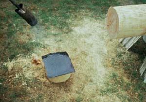

As protection against water wicking up from below, I seal the bottom end of the log with torch-down roofing. With a torch, heat a piece of roofing material that’s slightly larger than the base of the log and – while wearing gloves – adhere the hot roofing membrane to the bottom of the log (Figure 5). When it cools, trim it with a utility knife to match the bottom of the log and slit it at the plunge cut.
Figure 5. A propane-fired torch is used to heat torch-down roof membrane. Once heated, the membrane will be adhered to the bottom of the log post and trimmed to fit exactly. This membrane helps prevent water from wicking up the log and causing rot.
The log post will be attached to the HD-10A with through-bolts, and your next challenge is to drill the holes for them. Use a level to orient the log so that the plunge cut is horizontal.
Using the same technique as before, draw a plumb line from the center of the plunge cut to the upward face of the log as it lies on the sawhorses. Draw a matching line on the other end of the log and snap a new line down its length. The bolt holes will be on this line. Measure the height of each hole in the HD-10A from the top of the pedestal and transfer these measurements to the new chalkline.
The next step is a two-person operation. One person drills the hole, and the other guides the 11/16-inch augur bit with a layout square and a torpedo level (Figure 6).
Figure 6. A torpedo level and a layout square are used to guide the drilling of holes for the bolts that will secure the log to the anchor.
With the holes drilled, slip the log over the HD-10A and see if they match up (Figure 7). Slide the 5/8-inch bolts through the holes. The bolts should be about 1 inch longer than the diameter of the log so there’s room for the nut and washer. Plumb the post and brace it from two directions.

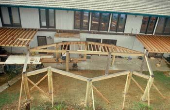

Once all the posts are installed, you can lay out their tops for the beams. There are several ways the beams can meet the posts: The beam can sit on top, it can sit in a pocket cut for the beam to run through, or it can sit in a blind pocket, where the beam end is hidden in the post.

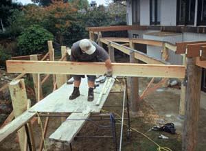

Pocket cuts require two parallel cuts for the sides and a plunge cut at the bottom. Working from scaffolding for safety, run a string line from post to post down the length of the deck to represent one side of the beam. Mark that side on the tops of the posts, then measure over and mark the other side. From these lines, draw plumb lines down the sides of the posts; then mark the bottom at the proper elevation and chainsaw out the pocket (Figure 8).
Figure 8. With the posts up and braced plumb, a string is used to establish the line of the beam. A carpenter uses a level to lay out the side cuts for the beam pocket.
Blind pockets are laid out and cut in much the same way, but the side cuts and the bottom plunge cut don’t go all the way through (Figure 9). Also, you’ll need to make a blind cut from above to end the pocket.
