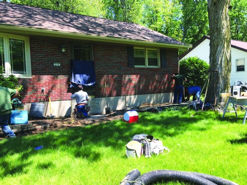

Helical Pier Foundation
I pulled a permit at the local building department and called Dig Safely New York (811), the underground utility marking service, and then I contacted our local Techno Metal Post installer. I like its helical piles for this type of project for several reasons. For one thing, I’m 62 years old, and I like to avoid digging deep holes by hand. Even better, helical piles are super strong and have a verifiable bearing load. They’re “fast and quick,” as I like to say, and once they’re installed, you’re immediately ready to start building. Finally, building inspectors like them because they come with a report from the installer stating the load capacity, depth, and all the necessary information that allows an inspector to sleep well at night.

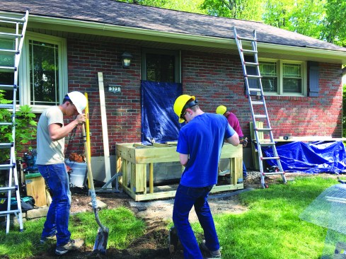

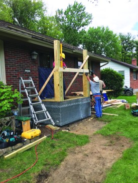

To keep rodents from burrowing under the enclosed porch, 12-inch-wide strips of diamond lath were nailed to the bottom of the framing and buried in the ground before the plywood sheathing was installed.
After we demolished the old concrete steps and the Techno Post crew had installed their two P2 piers, we ran a 4-inch-diameter solid drainpipe along the foundation behind where the new porch would be located. We needed to be able to collect the rainwater that would have been collected from the gutters that would now be interrupted by the new porch roof. We connected the pipe into an existing drain that is connected to the town storm sewer.

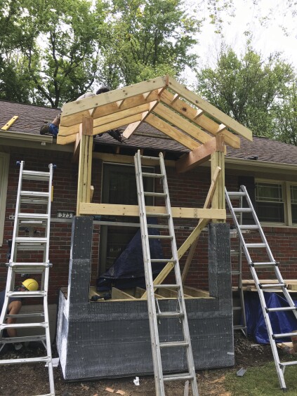

The porch framing was sheathed with PT plywood, wrapped with both SAF membrane and felt paper, and then covered with diamond lath prior to installation of the stone veneer cladding.

We framed the porch floor using typical deck construction and flashing details, though with oversized framing considering the deck’s small proportions. For example, we used 6x6 rather than 4x4 posts to support the triple 2x10 flush rim beam. And even though the joist span was only 84 inches, we used 2x10 joists 16 inches on-center so that the porch would feel solid and sturdy underfoot.

We planned to wrap the porch and the bottom half of the columns supporting the porch with cultured stone veneer cladding. In preparation for the cladding, we framed a short knee wall underneath the rim beam and two outside joists, stapling up foot-wide strips of diamond lath around the base to keep rodents out. Then we sheathed the wall with 3⁄4-inch-thick pressure-treated plywood glued and screwed to the framing (which also helped to reinforce the cleats supporting the ledger). To keep the plywood flat and dry, we stored it in our warehouse for several weeks prior to installation.
We wrapped the plywood with Grace Ice & Water membrane, followed by a layer of 15-pound felt paper. Since the cladding would extend halfway up the triple 2x6 PT columns supporting the porch roof, we used the same detail there. Then we installed the diamond lath, fastening it to the plywood with stainless steel roofing nails.

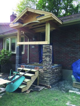

To install the side headers, we had to cut away part of the eaves and create a couple of pockets in the brick cladding and 1-by shiplap wall sheathing. After lining the pockets with flashing membrane, we slipped the triple 2x8 headers into place, using metal hardware and lag screws to fasten them to the house’s double 2-by top plate. Then we framed the roof with 2x8 rafters sheathed with 5⁄8-inch CDX plywood.
I like classical details and typically build cornice returns on almost all my houses. We dried the returns in with SAF membrane and copper flashing and finished them with some asphalt shingles that we had taken off the roof.
Next, we dried in the rest of the roof with SAF membrane, slipping the membrane under the existing shingles, which were only a year or two old. Then we called in our metal-roofing sub, who added his own brand of underlayment over ours and tied his valleys into the existing roof.
As we trimmed out the porch, we tried to match the home’s soffit and eaves details as much as possible. We finished the porch ceiling with beaded vinyl, capping the ceiling at the gable end with a decorative arch cut from 3⁄4-inch PVC trim. Then we Z-flashed the arch, and finished the gable with a couple of pieces of leftover vinyl siding and matching aluminum coil stock.

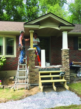

While we turned the standing-seam-metal-roof installation over to a sub, we tackled the stone veneer cladding that gives the porch such a distinctive look ourselves. One of our crew members worked for 18 years as a mason, so we often install stone veneer cladding like this on our projects.
Finally, we fabricated tapered columns out of PVC trim, which we installed over the built-up PT posts.
Tapered PVC column wraps dress up the triple 2x6 posts that support the gabled porch roof, which features nicely detailed cornice returns.

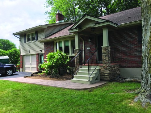

People with Alzheimer’s tend not to be very sure on their feet, so we researched our porch flooring choices carefully, focusing particularly on the COF (coefficient of friction), or slip resistance. In the end, we chose Koma’s Plantation PVC porch flooring, a reversible 1x4 tongue-and-groove profile with a smooth surface on one side and a textured wood-grain finish on the other. The company was very helpful, sending me a testing report and allowing me to speak directly with a tester so that I could put our client at ease with our choice.
On the stairs, we installed 2x12 PT stair treads with premilled grooves, later adding sand to the stain finish for even more traction. We temporarily supported the stringers with blocking while we assembled the stairs, then poured a concrete walkway with a stained finish that extends under the stairs to create a smooth and solid landing.

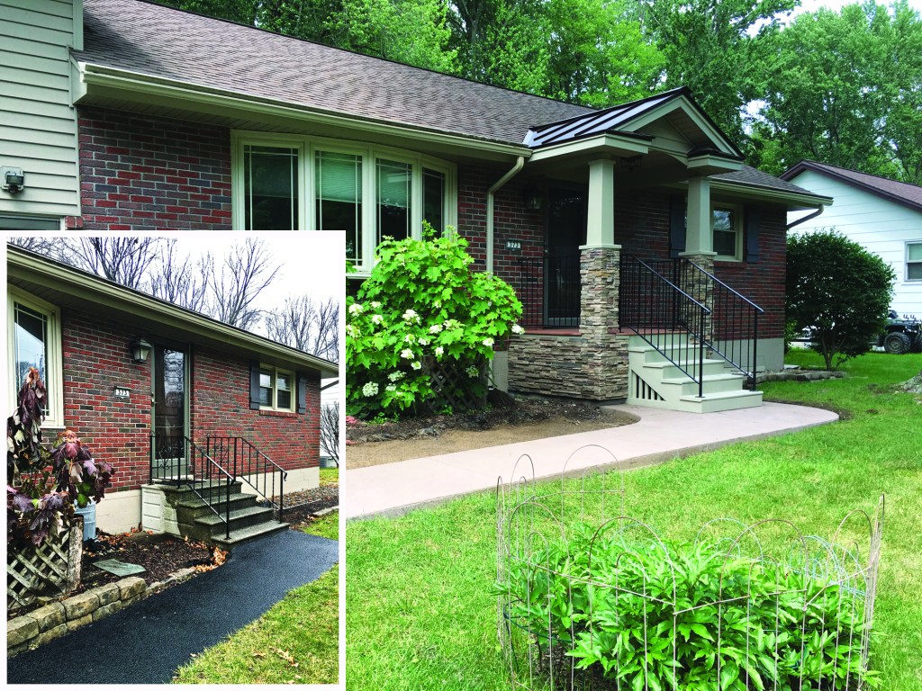

Along with a new poured concrete walkway and slip-resistant stair treads, the covered porch creates a safe and welcoming entry to the home.
A local welding shop custom-fabricated the wrought-iron railings. During framing, we had made it a point to install proper blocking so that the railing attachment points would be rock solid.
This was a good and worthy project, and the owners love the result. Based on the amount of traffic during the project, the locals love it, too. It does the job of keeping the owners safe and dry and gives them something nice to look at, too.
