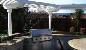

Find out which way the wind blows on a typical summer day at the time of day your clients plan to use their kitchen; they won’t want smoke from the barbecue blowing into the faces of their guests or into the house. Evaluate the sun’s path: Will you need to include a sun shade, roof, or pergola to make the space usable (Figure 3) Also think about the direction the guests will face and what the view will be. Will the cook have his back to the guests? A good design will address all these issues.
Figure 3. It's common for outdoor kitchens to see use in the late afternoon, when the sun is at a low angle. Building in a sunscreen is often a good idea (left). In rainy climates, a full roof is good plan (right).

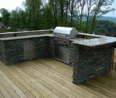

Armed with an understanding of your client’s needs and desires, you’re ready to draw up the design. As with indoor kitchens, there are three common layouts for an outdoor kitchen: the U-shape, the L-shape, and the straight line (Figure 4). The U-shape tends to provide the shortest distance between the main appliances; the L-shape gives the next shortest distance between elements; and the straight line makes for the longest walk.
Figure 4. To help plan a layout, Calise Outdoor Kitchens offers quarter-inch-scale drawings of its cabinets and kitchen components mounted on magnetic film. These can be arranged in different ways on a steel plate until the perfect configuration emerges.
Kitchens on decks are generally located in one of three spots. As long as the deck is large enough to accommodate it, a central island is usually the most desirable as it allows people to move freely all the way around it. The second option — placing the kitchen along the outer edges of the deck — works well on smaller decks. The third option is to install the kitchen against the house. I don’t recommend this, because smoke and grease from the grill will stain the side of the house and the eaves.
