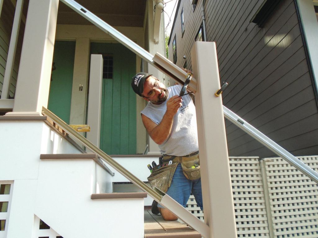

Stair Rails
Building inspectors in my area want multifamily units to have “graspable” stair handrails. Unfortunately, not many manufactured handrails technically meet IRC graspability guidelines: a maximum cross-section dimension of 2.25 inches and a perimeter dimension of between 4 and 6.25 inches for non-circular shaped rails. The narrower Emerge stair-rail profile I used doesn’t meet these guidelines, but it does have graspable finger holds on both sides of the profile and was approved by my building inspector for this project. Different inspectors have different interpretations for this rule.
Before I measured or cut anything, I verified that the upper and lower stair posts were plumb, then locked them in position by clamping them to my aluminum straightedge. Next, I made sure the intermediate post was plumb, and clamped that in position as well. To determine cut lengths and angles, I simply laid the bottom beam across the noses of the treads and marked where the posts intersected the beam.
By code, the triangle created by each tread, riser, and stair rail must be smaller than a 6-inch sphere. To meet that requirement, I always drop the bottom stair rail down as low as possible. However, this often creates a problem with post trim rings, which have to be cut to fit around the lower rail. Trim rims are usually pretty flimsy and subject to damage, so I carefully cut the notch out with a multitool.
For a snug and precise fit, I always start with a rail-section offcut to act as a template as I determine the correct cut angle. Once I’m satisfied with the angle and the fit, I mark the exact locations of the upper and lower assembled rail sections right on the posts. Even after carefully measuring, I always cut stair rails slightly long and make several more incremental cuts as I sneak up on the final length. Better to spend a little extra time at the saw than to end up with a gap between the rail and the post or—even worse—a railing that’s too short.
While upper- and lower-beam assembly for the stair rail is similar to the level-rail installation, the PVC mounting brackets are inserted into the ends of the beams prior to cutting, rather than afterward. A wrap of tape around the brackets ensures a snug fit while the cut is being made. The idea is to remove as little of the plastic on the bracket as possible while giving it the proper rake angle. If the bracket is left square, not enough of the mounting screws engage in the post, which weakens the connection between the rail and the post.
Unlike the balusters for the level sections, the stair-rail balusters must be cut to fit so that the handrail height is between 34 inches and 38 inches above the tread nosings, as required by code. To make sure the balusters are all the same length, I set up a stop block on my chop-saw table. The plug design allows them to rotate slightly within the slots in the lower rail and upper beam to accommodate different stair pitches.
