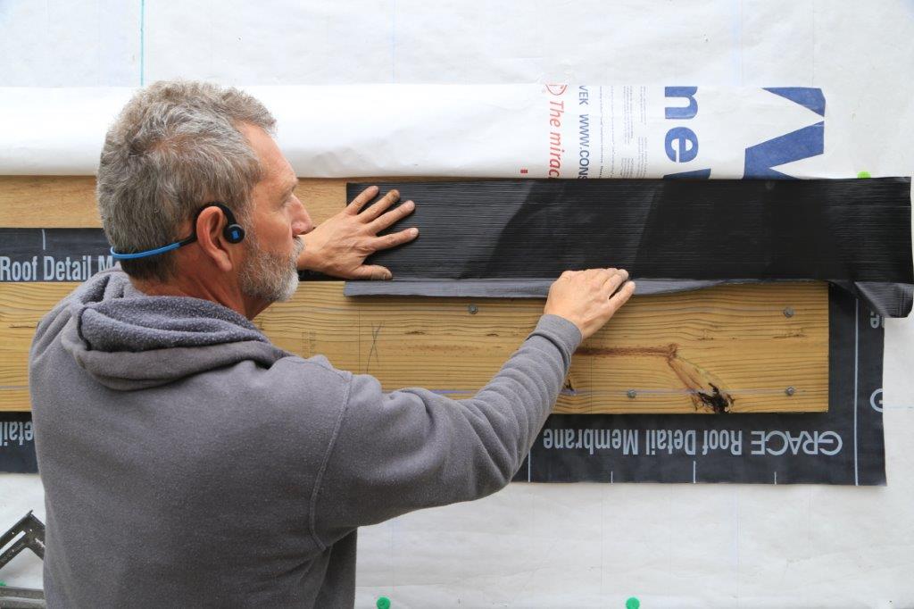

In dry climates, a simple metal or plastic cap flashing may be adequate to prevent water from contacting the band joist. But in wet climates, and especially where wind-driven rain is common, a more complex flashing system may be needed. I take a belt-and-suspenders approach and add an extra insurance layer. The material cost is negligible in the overall cost of a new deck, and on an average-sized deck, it takes only about an hour to assemble.
I use a three-layer system (see the slide shows). First, I apply a sheet of self-adhering, self-sealing membrane to the wall before installing the ledger over the membrane. Then I apply “pre-flashing”—a strip of self-adhering membrane that laps over the top of the ledger and extends up the wall. I finish up the flashing installation with L-shaped metal or plastic cap flashing.
