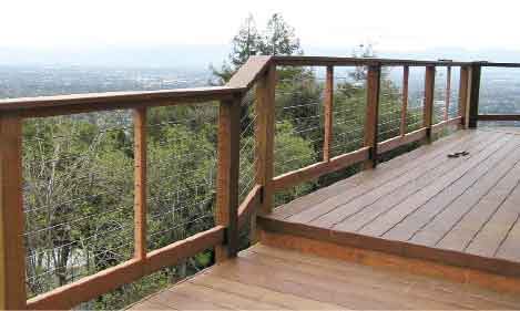

Since expansive views are common where I build decks, I’m frequently asked about railings that won’t obstruct those views. Two materials that work well are cable and glass, but because of the maintenance required to keep exterior glass clean, most of my clients choose cable.
Before I discuss the installation of cable railings, I’ll offer a couple of words of caution. Check with the local building authority before suggesting them to your clients, as some jurisdictions don’t allow horizontal railings. The concern is the potential for people, particularly children, to climb over them. Although some in the industry disagree, I think this concern is valid and I make my clients aware of it (especially if small children may use the deck); on occasion a client has opted not to use cable railings because of this issue.
Most of the decks I build are constructed primarily of wood, including the decking and the railing frames. While there are other options, including aluminum and steel frames, this article focuses on building a solid wood frame to support the cable.
Keep Cable From Sagging
I’ve adapted my standard railing design for use with cable, which interacts with the wood frame differently than other railing materials do. For one, because making the cables taut places a great deal of tension on the end posts, I use larger posts and insert sub-rails between them under the cap rail (Figure 1).
Figure 1. Cable railings exert considerable tension on the end posts. The solution is to use beefier end posts and fill in between them with sub-rails.
Another concern with cables is that they can wear away the wood on the inside of the holes they run through, especially at angle changes and corners. To protect the wood, cable-railing manufacturers supply fairly inconspicuous sleeves to line the holes (Figure 2). Without them, the holes would soon get larger, allowing the cables to loosen and sag.
Figure 2. Where cables turn a corner or change angle for a stair, liners are used to prevent the cable from wearing down the wood posts.
Finally, cables are very flexible, so they need to be supported more frequently than wood members to prevent sagging. I accomplish this by adding a vertical component whose only function is to maintain the cables’ horizontal spacing (Figure 3).
