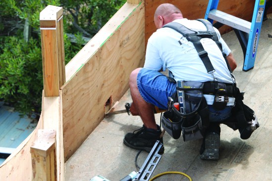

Water drains through scuppers cut into the bases of the parapet walls.

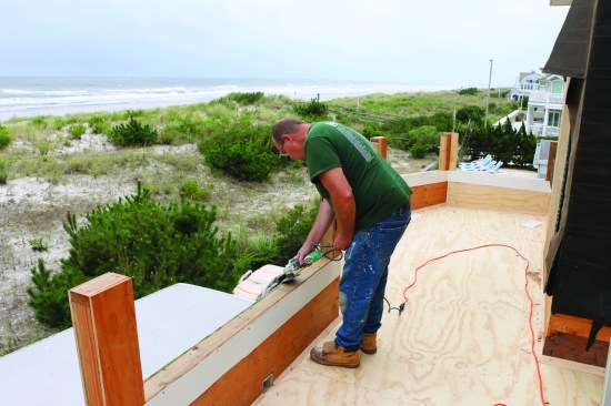

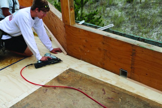

In addition to covering the subfloor with smooth 1/2-inch AC plywood underlayment, the crew eased the edges of the parapet wall with a grinder to prep the deck for the fiberglass contractor.
Once the floor framing was completed, we glued and nailed 3/4-inch AdvanTech T&G subfloor to the sloped joists. Then we framed the parapet walls with 2x4s—letting the framing extend up at each corner and facet to create posts—and sheathed the walls with 1/2-inch CDX plywood.
To allow water to drain from the deck surface, we cut holes for scuppers into the sheathed parapet walls. The actual scuppers are made from 4-inch-by-4-inch-square vinyl sleeves (the same ones used to cover posts in the railing and fencing industry). These sleeves are set flush with the inside of the parapet wall sheathing and rest on top of the subfloor. We set the scuppers at a slightly increased pitch and let them extend through the parapet wall just beyond the edge of the roofing.

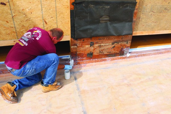

Before mixing anything, Brian used a rotary grinder outfitted with an abrasive disc to soften and clean up any sharp or rough plywood edges. Then he mixed up a batch of polyester putty—similar to auto-body filler—and covered the nail holes as well as the plywood joints. He also puttied around the scuppers, filling in any gaps between the sleeves and the plywood.

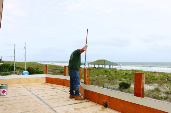

All the surfaces, including the top of the parapet wall, that would receive the fiberglass covering were primed with a “hot coat” of resin. The crew worked from the top down.

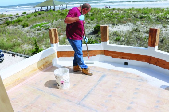

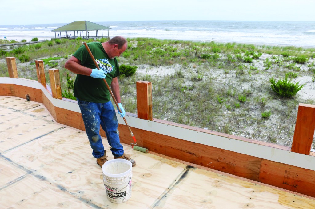

The next step was “hot coating” all the deck surfaces by applying resin with a thick-nap paint roller. Working with fiberglass calls for many single-use tools—once the resin cures, paint rollers and brushes become rock hard. So Brian uses disposable products: cheap paint rollers, disposable paintbrushes, and 5-gallon-bucket liners. For detail work, he also uses plastic or aluminum rollers that are reusable and that are made specifically for fiberglass work. These tools can be cleaned with acetone before the resin cures, but it’s challenging and the fumes are dangerous.

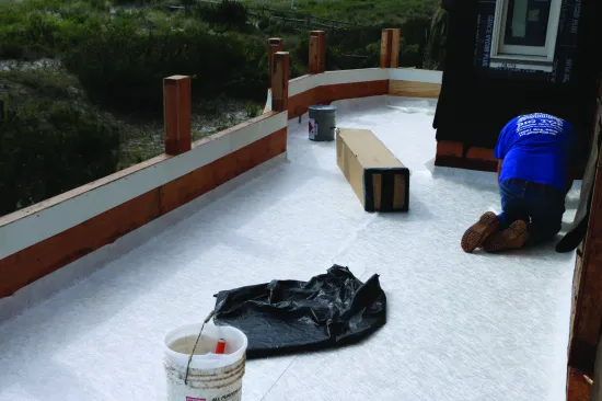

After the resin was allowed to cure for a day and then sanded smooth and thoroughly vacuumed, a layer of 1.5-ounce chopped fiberglass mat was spread out over the deck surface. Note how the mat extends up the parapet walls, to create a pan.

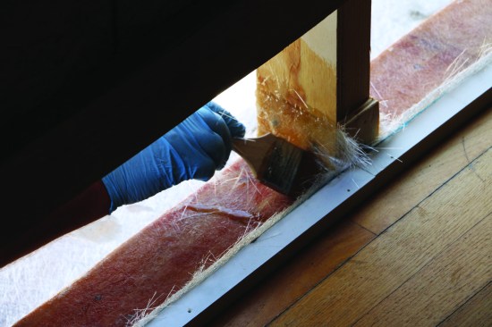

At the thresholds of the doors leading onto the deck, he applied resin up the framing and sheathing. Finally, he put a liberal coat of resin over the entire flat surface of the deck. It should also be noted that Brian mixes only a little resin at a time. The working time of mixed resin is limited and a large volume of material will usually “kick” more quickly. Smaller batches ensure that the resin does not begin curing before it is applied. Once the hot-coat resin cures, the deck is temporarily sealed. A rainstorm at this stage would not be ideal, but it wouldn’t ruin the project.
The next day, Brian started by grinding all the hot-coated surfaces, again using a small grinder fitted with an abrasive disc. This process removes irregularities and abrades the surface for the next coat. When finished, he blew the dust off the deck with an electric leaf blower.
Next, he laid out 1.5-ounce chopped fiberglass mat over the deck surface. He let the mat extend up the parapet walls about 6 inches and lapped it about 4 inches into the scuppers. He used smaller scraps to complete the mat layer around the scuppers, both inside the parapet walls and where the scuppers exited on the outside.
He cut strips of mat about a foot wide for the tops of the parapet walls and let the strips extend up a few inches at each post and down the sides of the parapet, overlapping onto the coil stock. At the door thresholds, where we had added temporary dam strips to protect the floors inside, Brian ran the mat up onto the dams, again adding small strips to complete the corners of the mat layer. At the seams in the field, the mat sections overlapped by 4 inches to 5 inches.

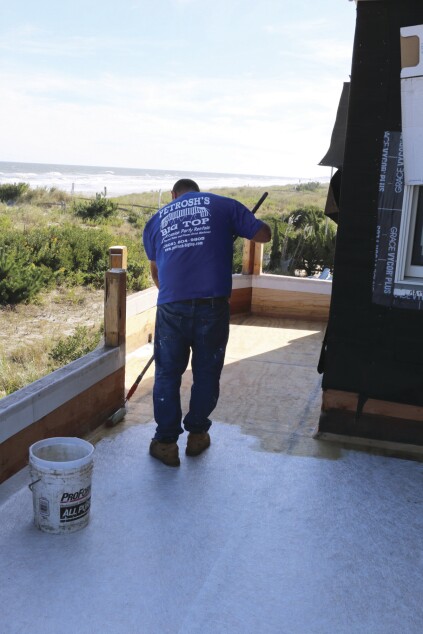

When all the pieces were cut, Brian began soaking the mat with the mixed resin, starting with the tops of the parapet walls. For the larger surfaces, he again used a disposable paint roller. For tighter details like inside corners, he soaked the resin into the mat with a disposable brush. When completely soaked with resin, the mat becomes transparent.
After finishing the tops of the parapet walls, he turned his attention to the door thresholds. This time he used a specialty roller to push the resin into the mat. The roller also helps to work out any voids or air bubbles under the mat.
Next, Brian worked on the base of the parapet walls, using a paint roller to soak the resin into the mat where it extended up the walls. Finally, he poured resin over the main surface of the floor and pushed it around with a paint roller until the entire mat was saturated and transparent.

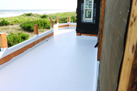

The cured gelcoat provides a durable, weatherproof walking surface, though PT sleepers could also be glued to the fiberglass and standard decking applied for clients who don’t like the look or feel of fiberglass.
When the surface was abraded and dust-free, he applied the fiberglass gelcoat to the surface, beginning with detail areas such as thresholds. The gelcoat is a two-part product that has the consistency of paint. Brian used a disposable paintbrush to make sure that all the nooks and crannies received a liberal layer of the gelcoat.
As with the resin layers, Brian used a paint roller to coat the tops of the parapet walls and the transition between the inside parapet walls and the horizontal deck surface. Then he rolled out the main deck surface and his job was done.
