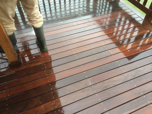

A. We’ve stripped far too many failing film coatings (like the old Sikkens formulations) from ipe and other tropical hardwoods to think they’re a good idea. Ipe is just too dense and oily to make a good substrate for film-forming finishes, and even has a hard time accepting penetrating oils. Even so, a good penetrating oil with a high trans-oxide pigment content is our preferred ipe finish; we’ve had the best luck with Penofin’s Marine Oil. Armstrong Clark oil-based stains are also very good. Many of our clients have reported success with Ipe Oil, though this isn’t a product we have personal experience with.
Even when the manufacturer recommends two coats, one coat of penetrating oil is plenty for ipe—though you’ll need to follow up with at least an annual maintenance coat. After stripping the old finish from your deck, I would sand the decking with 80-grit paper to improve absorption. The finish should simply be brushed on, then any excess wiped off within 15 to 20 minutes. When you’re refinishing, depending on the length of the deck and the pace at which you work, this may mean brushing three to six courses at a time, and then going back to wipe off excess. Don’t get so far ahead of yourself that you can’t reach back to where you started, because you definitely don’t want to walk on the wet oil.
Fixing Water Spots
Q. I oiled my client’s ipe deck recently with Penofin Marine oil, but unfortunately, unexpected rain showers passed through the area about 12 hours after I finished, and now there are distinct water spots on the deck. Do I need to power-wash the entire deck and start over, or can I just re-oil the boards that are spotted?
A. You should be able to scuff-sand the spotted areas with 80-grit paper and re-apply penetrating oil. Whenever you sand, however, be sure to remove sanding dust from the surface by vacuuming thoroughly or by tack-wiping the area with mineral spirits. Otherwise, the dust will mix with the finish, creating a muddy-looking surface. Finally, wipe off the excess oil within 20 minutes of application.

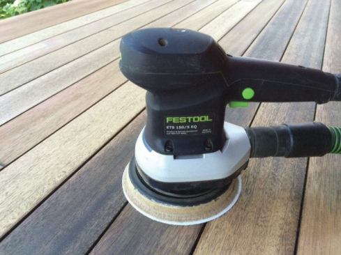

A. Your safest bet would be to sand the decking, then vacuum thoroughly and apply oil immediately. If the deck is large, it might make sense to rent an upright orbital floor sander. When sanding, don’t use anything any finer than 80-grit.

Q. I’m planning on prefinishing my client’s new ipe decking on all four sides prior to installation, per your recommendations. But do I need to wash it first with a product like Penofin’s First Step, which promises to remove mill glaze and “open the pores of the wood” so that the oil finish will be absorbed more readily? And if I prefinish the decking, how long should I wait before installing it?
A. You don’t need (or want) to wash new ipe prior to finishing it. Usually all we do is give it a quick sanding using 80-grit paper, which removes any mill glaze (the soft sheen on the faces of the boards from the cutters of the planer they were passed through) and preps the surface for a finish. We use orbital sanders with very effective dust extraction, so we don’t worry about sanding dust. Otherwise, be sure to vacuum thoroughly, then wipe down the decking with a tack rag soaked with mineral spirits before brushing on the finish. We let the boards sit for about 15 minutes, wipe them down, then flip and repeat the process, making sure to hit both edges too. Then we place the boards on a drying rack, where they can sit for a day or so (depending on temperature and humidity) until they are thoroughly dry. Afterward, be sure to soak the oily rags in a water-filled bucket to avoid the risk of spontaneous combustion.

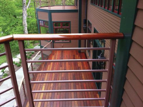

Oil for Ipe Handrails?
Q. My client’s stone patio will have an ipe railing with stainless cable infill. Should penetrating oil be used for the handrails and vertical posts?
A. On handrails and vertical surfaces, I prefer to use a marine-grade spar varnish with a matte finish, such as Pettit Z-Spar Captain’s varnish or Epifanes Wood Finish Matte. Spar varnishes contain UV blockers that help prolong the life of the coating, and while this kind of finish requires more maintenance than a penetrating oil, it will look better and provide a better feel to the hand. We sand the surfaces to 150-grit, then apply about four coats of varnish, scuff-sanding at successively finer grits between coats.
