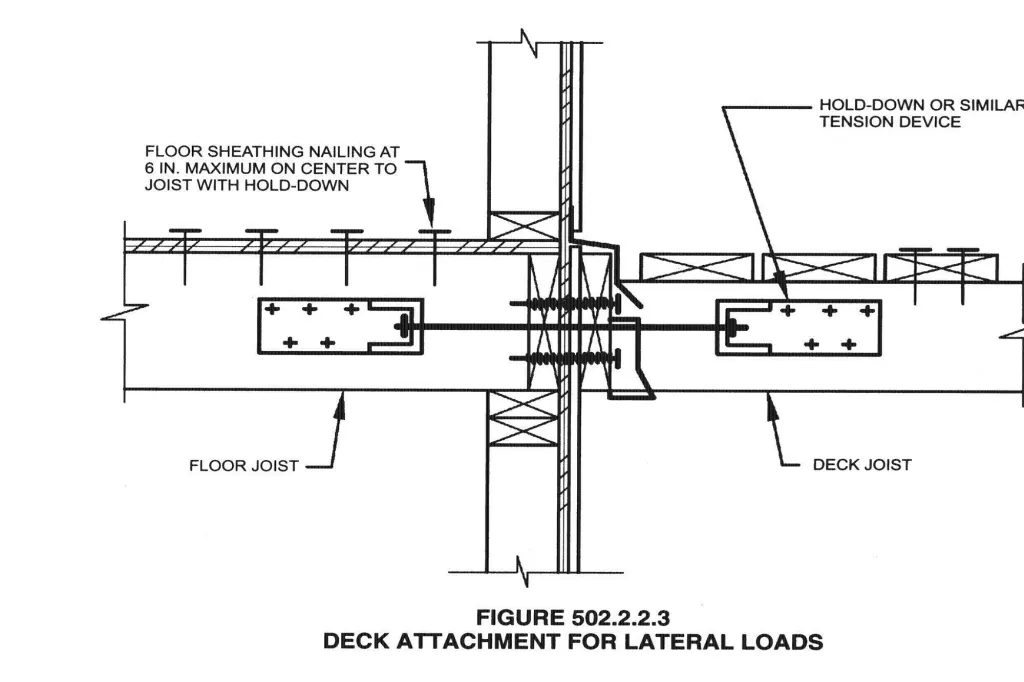

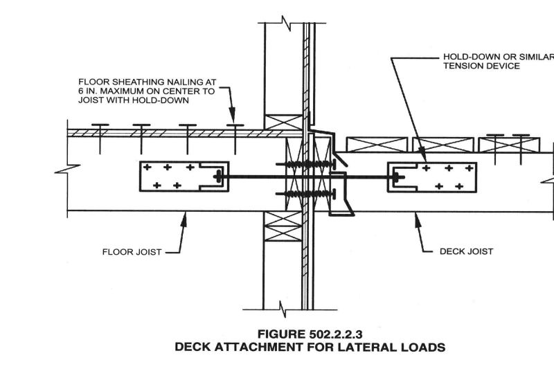

The lateral-load anchor “permitted” by the current IRC requires access to the interior house framing. In an existing house, it’s impossible to verify that the subfloor attachment meets requirements without removing finished flooring.

The 2009 IRC, which is the building code in my area, requires that a deck connected to and supported by its primary structure be “designed for vertical and lateral loads as applicable” (2009 IRC, R502.2.2).
The IRC’s vertical load requirement is clear: 50 pounds (40 live plus 10 dead) per square foot. Using a deck’s dimensions, you can easily calculate its vertical load on the connection between the deck ledger and the house band, and then refer to the code to find connection details and attachment configurations.
However, the IRC’s lateral load provision—intended to prevent a deck from being pulled away from its supporting structure—is anything but clear, as most deck builders know.
Instead of quantifying general lateral load requirements, the code offers a single solution with a specific design capacity: You are “permitted” to install the mechanism drawn in IRC Figure 502.2.2.3—two Simpson Strong-Tie DTT2s (strongtie.com) connected by a threaded rod, with one fastened to a deck joist and the other to a house joist. Two of these mechanisms, each resisting 1,500 pounds, must be installed, regardless of the deck’s size or shape.
Note that the IRC does not require this detail, nor does it set a lateral load requirement of 1,500 pounds. That load is merely what the allowed “hold-down device” should resist.
Unfortunately, installing this device poses numerous difficulties, especially after a house is built. Not only is it labor-intensive, it’s arguably unnecessary for many decks (see Bad Solution to a Non-Existent Problem, page 40). In fact, lateral load requirements are slated for revision in upcoming versions of the IRC (see Structure).
