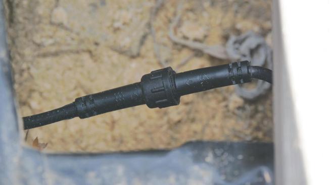

Wiring. What makes low-voltage lighting so simple to install is the wiring, which consists of two wires that are usually bonded together as one in a waterproof, flexible direct-burial sheath (no conduit required). This cable comes in multiple gauges and can be split in half when necessary.
The size of wiring available in your region may vary depending on your weather conditions. Here in the mild Pacific Northwest, where 16-gauge and 12-gauge wire is widely available, I generally use 12-gauge wire. When I’m running more than 500 feet of cable (which is not common on a deck, though maybe more common when the system includes landscape lighting), I’ll switch to even larger diameter 10-gauge cable for the supply lines to minimize voltage drop.
Low-voltage two-wire cable is UV-protected and weatherproof, so it doesn’t have to be run in conduit.

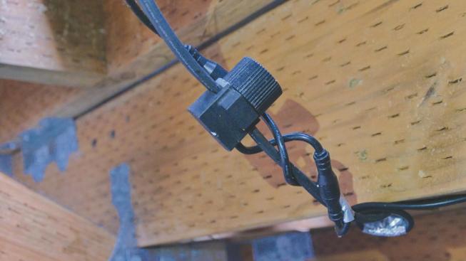

While there is no industry standard for fittings, companies like In-Lite offer high-quality waterproof cable connectors for extending lines, connecting fixtures to supply lines, and adding branch lines.
The low-profile fitting can be easily pulled through small-diameter holes drilled through the deck framing.
The In-LIte Easy-Lock connector allows you to tap into the DC power supply line without using tools.
Most LED systems will operate fine on 12-gauge wire, with a single hook-up to the transformer. Some larger transformers have higher voltage poles to hook up wire to. For example, there might be 13.5-volt and 15-volt terminals on your nominal 12-volt transformer. If you’re not sure of the proper wiring configuration, consult the manufacturer in regards to wire thickness, length, and transformer size.

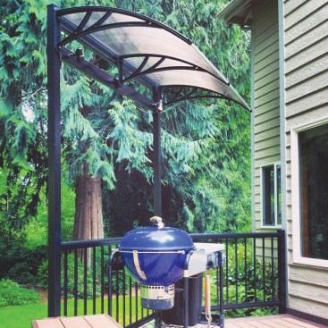

A good outdoor lighting plan should include task lighting at grills and dining areas.

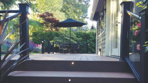

Decorative lighting. When considering the placement of decorative or accent lighting fixtures, you don’t need to be traditional. I’ve seen many creative examples of lighting on floors of decks, up privacy walls, and under benches to create indirect lighting as well.

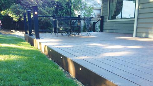

Decorative lighting can also serve a practical purpose. For example, I like to include multiple 1-inch round LED lights in my projects, using them on stairs and at transitions to highlight safe paths from upper to lower areas.
Measuring less than 1 1/2 inches in diameter, small puck lights are ideal for providing practical lighting in stair risers.
Fascia-mounted puck lights can also be used to mark transitions when a deck changes levels.

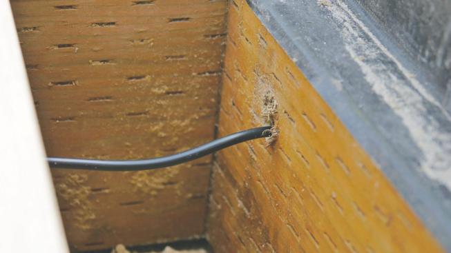

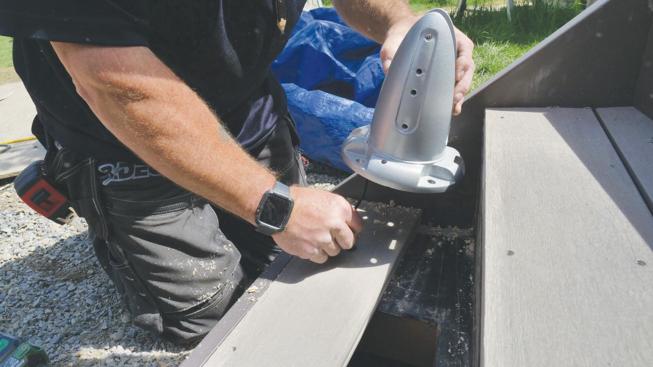

Once the transformer location and light-fixture locations have been determined and you know approximately how much wire will be needed, it’s time to create a path from the transformer to each light location. Before installation, though, it’s a good idea to test your light kit in place in the dark to make sure lights are spaced correctly and lighting levels are what you expect.

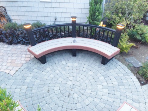

Post-cap lighting adds both safety and style to outdoor areas.

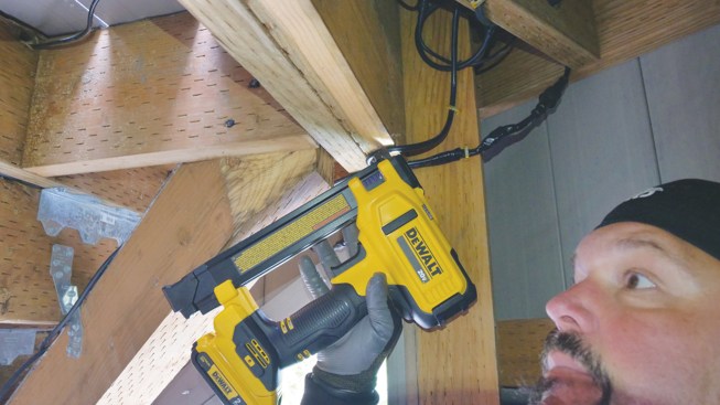

I pay a lot of attention to wire management, during and after installation. The liberal use of cable zip ties and staples goes a long way toward keeping things looking tidy under the deck.
Cable staples can be tapped in manually, of course, but it’s faster to use a staple gun. Arrow makes an inexpensive cable staple gun, the T-59, that looks similar to its standard T-50 stapler. Another option is DeWalt’s new cordless cable staple gun, which I’ve just acquired. It runs on DeWalt’s 20-volt platform and makes effortless and quick work of securing cable to the frame of a deck.
A cordless stapler makes quick, neat work of running the wiring for the low-voltage system.

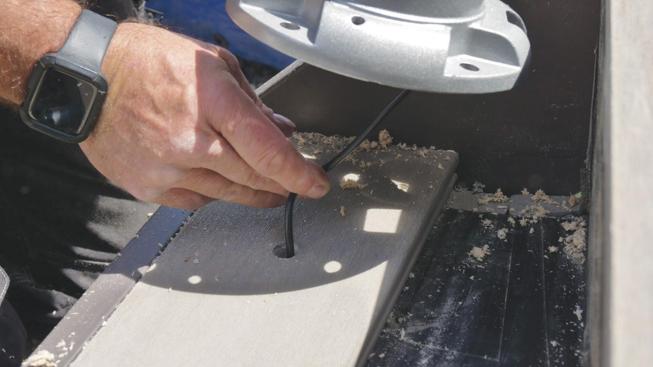

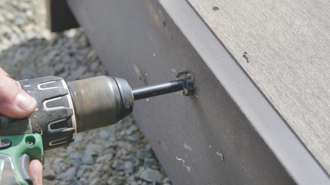

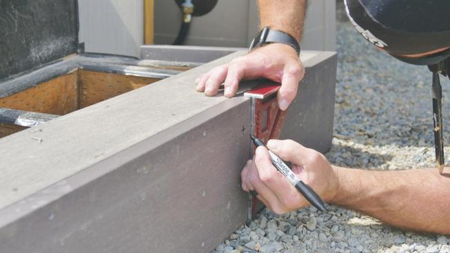

To install a puck light, the author starts by carefully laying out the hole location.
Next, he drills the proper diameter hole with a Forstner bit, which creates a clean hole in composite material.

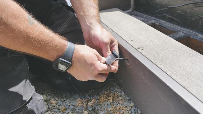

Then he connects the puck to the supply wiring.

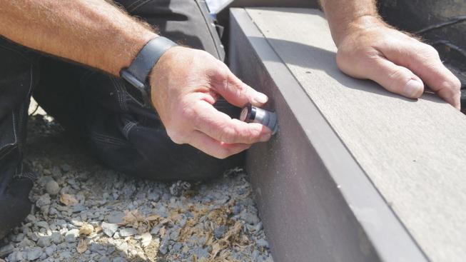

Friction holds the puck light in place.

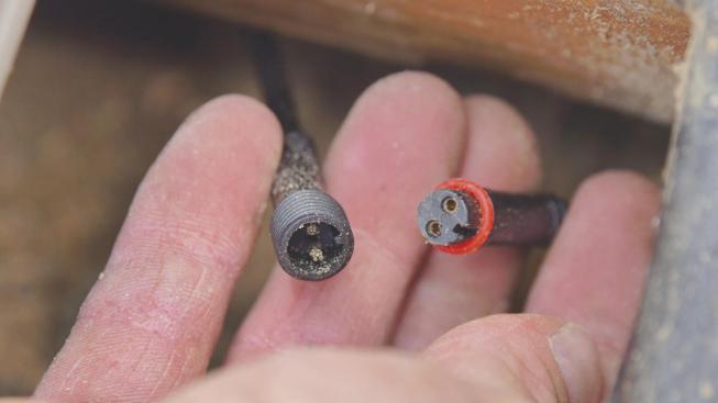

For the past several years, however, I’ve been using In-Lite’s cable and lighting system. Each light comes with a special connector that works with 12-gauge wire and larger. The connector has three stainless steel barbs in its base for each wire; the barbs pierce the wires to make a positive connection to both wires at the same time. Then dielectric grease encompasses each barb to ensure a long-term connection.
I like the In-Lite connectors because they provide a solid, positive connection that installs with minimal effort and doesn’t compromise the integrity of the main wire—no splicing is required. The downside is they are slightly bulky, so plan to spend a couple of extra minutes organizing the connection points.

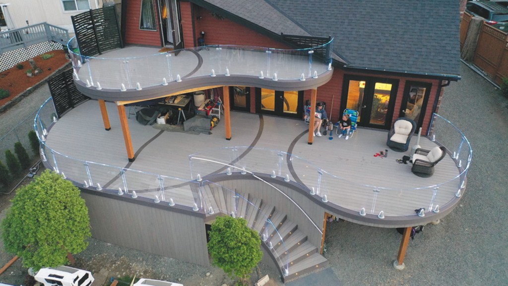

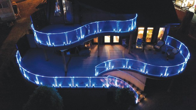

If you want to create an amazing lighting experience on your client’s deck, consider Regal Ideas CrystalRail. CrystalRail is a unique system in which special pods hold low-iron glass and emit light through it. At night, the glass glows blue, to incredible effect. Regal Ideas also sells traditional aluminum-framed glass systems that are lighted.
One of the most striking lighting fixtures that the author has used on his projects is the CrystalRail system, from Regal Ideas, which consists of aluminum mounting brackets that anchor tempered-glass panels.
The CrystalRail brackets are fitted with built-in LED lamps that connect to the deck’s low-voltage system.
The LED fixtures in the mounting bases illuminate the edges of the glass panels, providing a dramatic nighttime look to the deck from all directions.
The combination of illuminated glass panel railings and puck lights mounted in the risers elevates the style of this lakeside deck.
