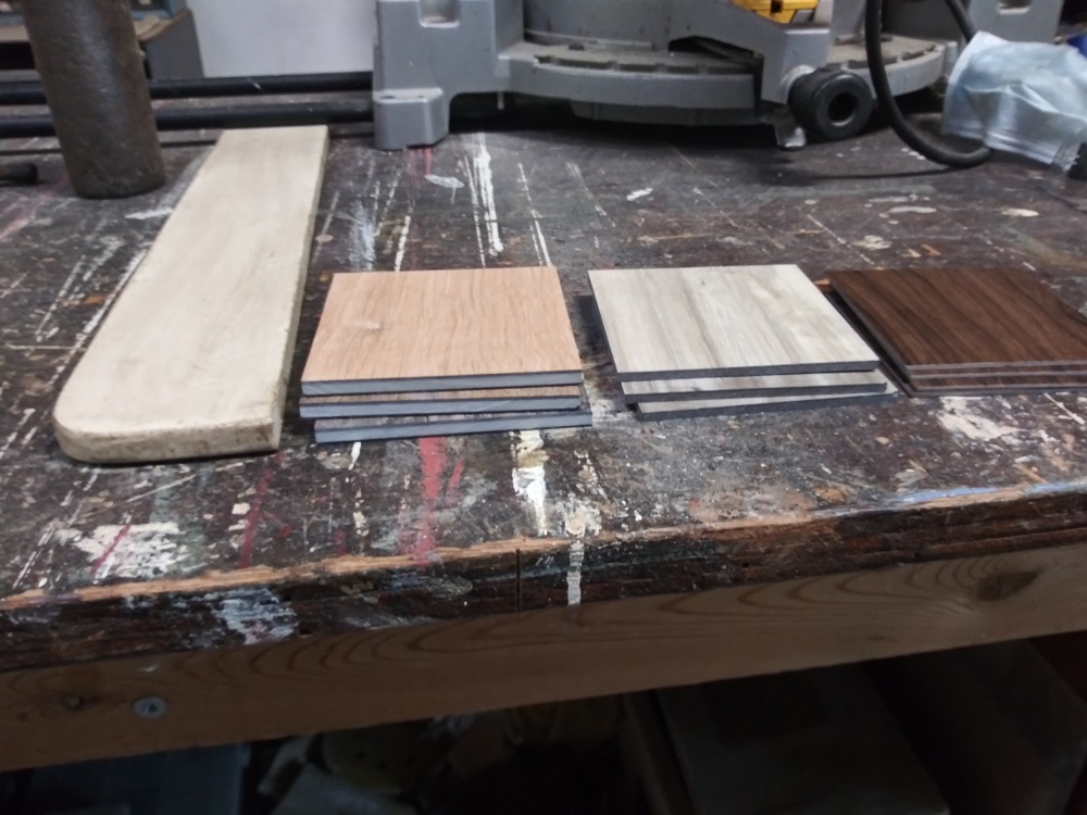

One alternative to conventional shims that has come in handy in my work is scraps of vinyl flooring. Home centers are a great place to pick up material samples, which usually measure about 3 inches square and vary in thickness from 1/16 inch to over 1/4 inch thick.

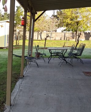

Need convincing? About 10 years ago, I made standoffs from ½-inch-thick HDPE shims for the 4×4 posts supporting the roof over my backyard patio. The posts are still in perfect shape, and so are the shims.
