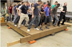

Lateral loads due to occupant movement are another matter. Building codes are silent on the subject of these loads, with the exception of grandstands, bleachers, and stadium seating. So the WSU team performed laboratory experiments on full-size decks with two types of occupant loadings: cyclic side-sway, and impulse (run and jump stop). What they found is that lateral loading from occupants can exceed the worst-case design loads from either wind or seismic forces. A key point is that extreme occupant loading can occur anywhere and on any deck, while extreme wind and seismic loads are limited to smaller geographic regions.
