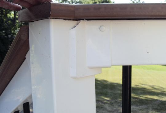

Carefully consider the brackets you use and any modifications that may need to be made (photo, right). If you want to use a flat cap but the standard brackets extend beyond the rail, you may be forced to shorten the brackets on site. This takes time, occasionally delivers poor results, and can be dangerous. If you do cut the brackets, make sure the rail panels are still well-secured and supported. My current vinyl-railing manufacturer was able to source some “bucket-style” fence brackets instead of brackets that completely surround the railing. Now I don’t have to cut brackets on site — which saves time and reduces my liability.

Carefully consider the brackets you use and any modifications that may need to be made (photo). If you want to use a flat cap but the standard brackets extend beyond the rail, you may be forced to shorten the brackets on site. This takes time, occasionally delivers poor results, and can be dangerous. If you do cut the brackets, make sure the rail panels are still well-secured and supported. My current vinyl-railing manufacturer was able to source some “bucket-style” fence brackets instead of brackets that completely surround the railing. Now I don’t have to cut brackets on site — which saves time and reduces my liability

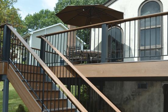

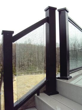

Many of my clients want a railing that doesn’t obstruct the view. Cable rails are a good option for this, but they aren’t popular in my area; I think they make an architectural statement that just doesn’t resonate here. I have found that using glass balusters or panels can accomplish the same end — in a dramatic fashion. Glass can be integrated into wood, metal, and many composite railings. Some vinyl- and composite-railing manufacturers have even begun to offer glass as an option.

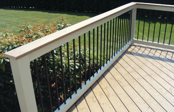

But glass does need to be cleaned, which discourages some clients from choosing it. I’ve also had a couple of clients who were worried about keeping it intact with rambunctious kids around. Though this last concern is pretty much unfounded (the tempered glass used for railings needs to meet strict standards), for such clients there are other options. Often, a simple vinyl rail dressed up with black metal balusters works well, because the black color causes the balusters to fade from view. Another possibility is a low-profile all-metal railing, which can be given extra character by combining it with a larger, composite rail post.
If the clients like low-profile metal rails but want a wider, more-traditional cap rail that can hold a cup, either use brackets that attach around the top rail to connect to the subrail and the newels, or predrill holes through the top rail so a flat cap rail (often a matching deck board) can be fastened from below with short screws. For additional support, drive longer screws through the deck-board cap down into the rail posts.

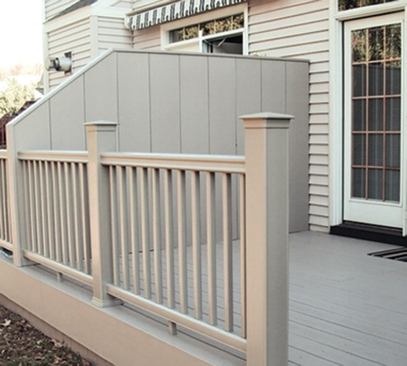

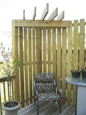

When clients don’t want to see or hear the neighbors at all, I’ll build a solid privacy wall. After framing it, I install decking or fascia boards on one or both sides and cap it with a matching deck board up top. Covering both sides can get pretty pricey, so I often use simpler construction on the side facing the neighbors.
If clients like the idea of a wall but don’t want to completely cut off the breeze, a shadow-box-style privacy wall with openings between the slats may be good compromise. In that case, since much of the PT framing will be exposed, I often stain the lumber to match the slats (before installing them).

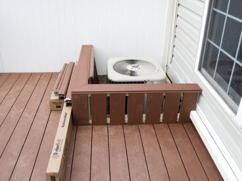

For clients who like the view from their deck but want some privacy from the neighbors when sitting down to eat, try a low solid wall. A similar design idea may work to mask objects such as air-conditioning units or utility boxes, but first check to make sure the rail doesn’t violate codes regarding access.

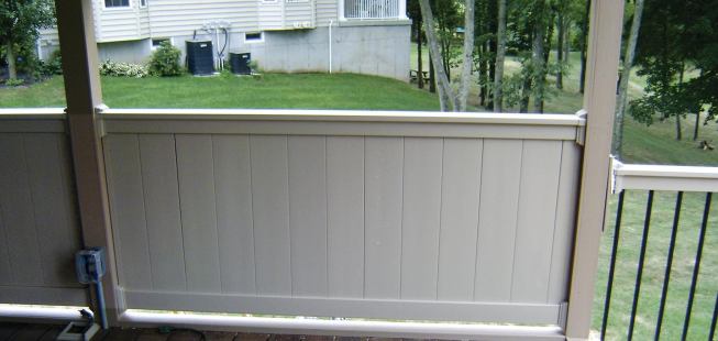

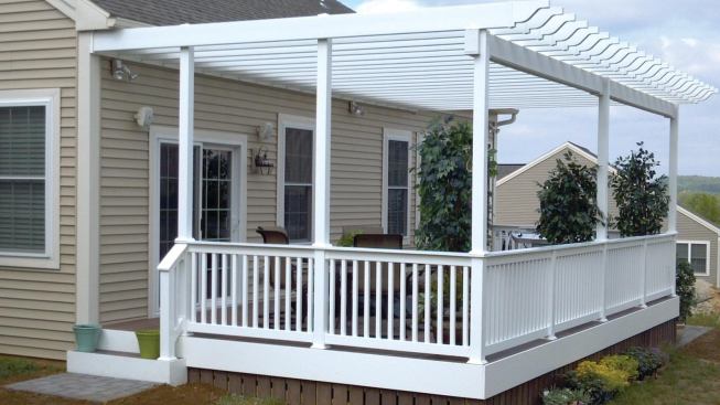

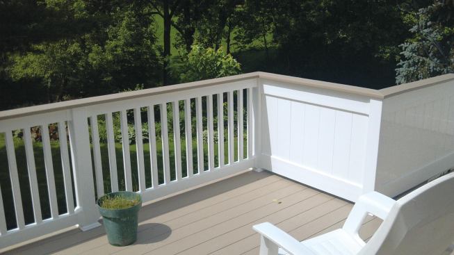

Sometimes clients require several different rail solutions, all blended into a single project. Perhaps they want to see the creek out back but want privacy from the sides — while not eliminating the cross-breeze. In one case, I worked with a local vinyl-railing manufacturer (GreenWay Fence & Railing Supply; greenwayfence.com) to create a standard-height rail using bottom rails in place of the top rails (see “Lessons From the Field”). This allowed me to install a flat Azek cap rail around the perimeter of the deck, with some sections filled with standard vinyl balusters and others with vinyl privacy panels. The railing thus offers privacy in some places and access to views in others, while still being consistent in design throughout. On a similar job, we built a custom pergola into the rails.
