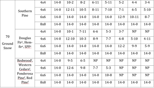

Among the dozens of proposals under consideration for the next (2021) edition of the IRC, of special interest to deck builders is RB184-19, a comprehensive reworking of section R507, the part of the building code that addresses residential decks. If the proposal passes as written, expect to see some big changes, including new guidelines for determining deck post height as illustrated in the chart below.
Table Courtesy Deck Code Coalition and the American Wood Council

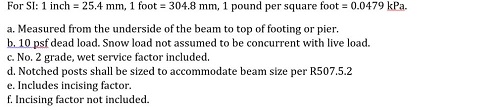

Fast forward to the next edition, the 2018 IRC, and at first glance it appears things got worse, since the 4×4 maximum height limit dropped to 6-ft. 9-inches. What happened? What happened is that the code provided more flexibility, but only if you carefully read the new footnote ‘c’. Codes have long required that all plies of a built up beam must bear on the post, so naturally a 4×4 (at only 3 1/2-in. wide) can only carry a three inch wide two-ply beam. Thus, the area of deck that can be supported by a 4×4 post is limited to two-ply beam spans. The 2018 height reduction recognizes proprietary post-to-beam connection hardware that will fully support a three-ply beam on a 4×4 post. With larger beams, the limit of deck area that could be supported increased, therefore decreasing the maximum post height. Fortunately, this was all explained in footnote ‘c’, allowing the previous 8-ft. height only when the more common two-ply beam is installed.

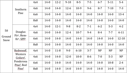

The more comprehensive post sizing Table R507.4 proposed by NADRA and other members of the Deck Code Coalition was developed with generous engineering contributions from the American Wood Council. If approved, the new table will allow posts to be sized based on the actual tributary area each post supports, and the different snow loads that a region may require. (The tributary area is simply half the joist spans, half the beam spans, and all the cantilevers that a post is within; the area of the geometric shape within those lines is the tributary area.) For small areas, such as a stair landing, the new table allows 4×4 posts to be as tall as 14 feet.
As you can see by looking at the table above, another variable addressed by this new proposal is the wood species of the post. Again, referring back to our toothpick analogy, compare the strength of a hardwood toothpick to one made with balsa wood. Clearly, one would snap before the other, and the new table reflects the fact that different wood species should yield different maximum post heights.
