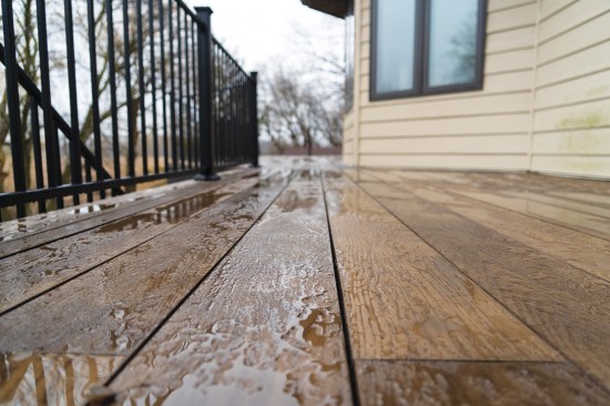

The project featured in this article was located in Shoreview, Minn., a northern suburb of Minneapolis. The climate is challenging, with sweltering summers and frigid winters filled with ice and snow. In our experience, Millboard responds well to the swings in temperature and humidity in this area, offers great traction even when wet, and stays cooler underfoot in the summer than other manufactured decking we’ve used.

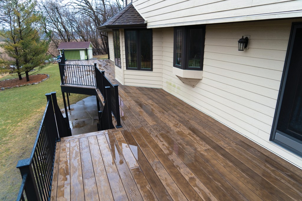

Steel framing. We framed the deck with Fortress Evolution steel framing, an upgrade that we encourage, and that most of our customers opt for. With possible beam spans up to 20 feet and a contemporary painted black finish, Evolution framing was a good fit for our client’s large, elevated deck, which overlooks a backyard pond.

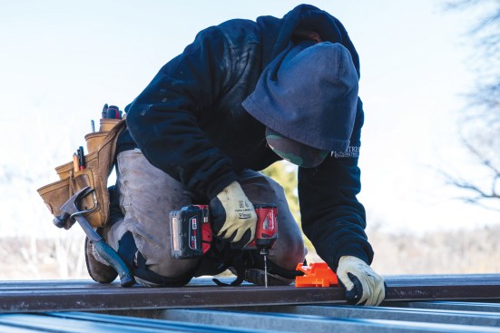

Evolution framing comes configured for joists on either 12- or 16-inch centers, spans that match up well with the requirements of our decking offerings, including Millboard. When Millboard is installed over a steel frame, however, the company’s Plas-Pro recycled-plastic subframing material has to be mounted to the sides of the steel joists so the decking can be properly fastened with the manufacturer-recommended screws and maintain the warranty.

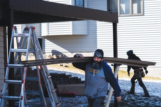

Millboard is available in 12-foot lengths.

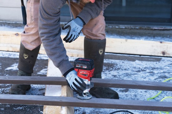

After ripping a board to width, a worker routs the cut edge to match the original profile and remove cut marks and any sharp edges.

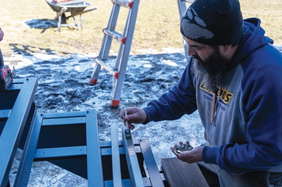

A worker brushes manufacturer-supplied touch-up paint to cut edges and end cuts.

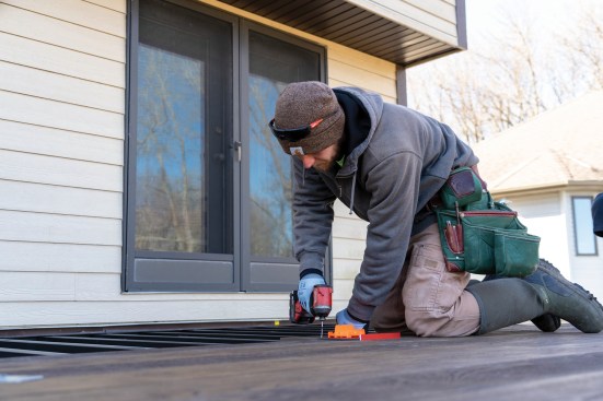

Hidden fastening. While many companies offer hidden fastener systems, Millboard doesn’t require clips or slots. Instead, the boards have a “self-healing” Lastane rubber top coat; fasteners are driven through the face of the boards, and the screw heads are buried beneath the surface, leaving a barely visible witness mark behind. We use the recommended Durafix stainless steel screws offered by the manufacturer, coating them with a silicone spray (again per the manufacturer’s recommendation) prior to installation, no predrilling required.
On steel framing, the decking is fastened to Plast-Pro plastic cleats. These attach to the sides of the joists.

Boards can also be edge-fastened, using the company’s DuoFix guide. Millboard offers decking spacers to ensure equal spacing throughout the deck.

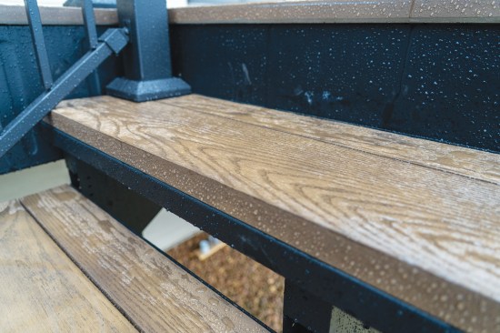

Enhanced grain on the Millboard helps provide traction when it's wet.

While bullnose boards are available for stair treads, the author typically installs square-edge boards on Fortress steel framing.

Cutting and touch-up. The boards don’t require any special handling or tools. We have had no problems with scuffs or blemishes from shipping to date. To prevent damage during construction, we locate our cutting station away from the deck. This helps keep the dust from blowing onto the deck—though if dust or dirt does get on the surface, it washes off easily with a hose.
A thick, matching touch-up paint is sent to each job to paint and cover all cut ends. We also use it to coat edge cuts. ❖
