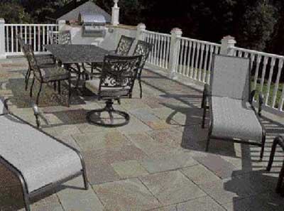

My company builds decks, and every so often a customer wants one with stone or concrete pavers rather than the usual decking materials. A client we recently worked with wanted his deck to match a stone patio below — which he wanted to be dry, with a finished ceiling above to boot.
We made the deck above watertight and framed it stoutly enough to support a covering of the same material that would be used to pave the patio. Laying the pavers was pretty straightforward, but before we were ready to put down the stone there were a lot of details to nail down: the weight of the stone surface, the amount of support it would need, waterproofing, mounting the newel posts, drainage, and so on.
When you lay pavers — whether natural stone or cast concrete — on the ground, you typically install them on a bed of 6 inches of compacted crushed stone that’s topped with a 1-inch layer of sand. The sand is used to fine-tune the elevation as the pavers are placed.
Once the pavers are set, you brush polymeric sand between the joints and water it down. It then permanently adheres to the pavers and solidifies within the crevice. Normal sand, on the other hand, washes out, dirt blows in, and then the weeds grow.
On a deck, the approach for installing pavers differs mainly in the base (Figure 1). Six inches of crushed stone is out of the question, of course. It’s not necessary, and would add tons to the load on the deck.
Figure 1. The details that go below the pavers count the most. They begin with a stout frame to support the additional load, followed up with an OSB floor that’s topped with an EPDM waterproofing layer. One inch of sand follows to make a bed for the pavers.
Tapered sleepers provide a 3/16-inch-in-12-inch pitch for drainage. The EPDM waterproofing runs up the house wall at least 6 inches and is adhered to the wall. The housewrap or building paper serves as counterflashing.
Only the sand — still a 1-inch layer — is used below the pavers, to allow adjustment for variations in the thickness of the pavers. But even without the crushed stone, the framing, which includes an OSB substrate, must be beefed up to support the weight of the pavers.
