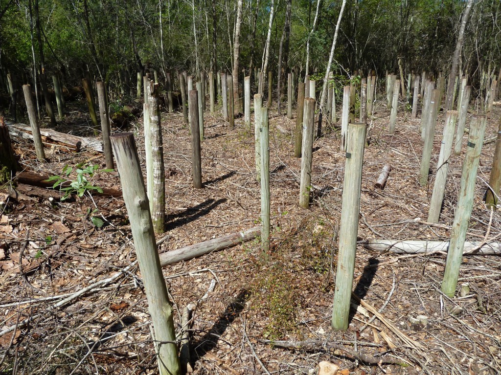

The test plot at the Harrison Experimental Forest in Saucier, Miss.—classified as a severe decay hazard according to the AWPA Fungal Decay Hazard Map—is filled with longleaf-pine posts.

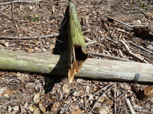

A: Grant Kirker, a research forest products technologist at the USDA Forest Products Laboratory in Madison, Wis., responds: Fence posts rot when decay fungi find wood they can digest. Insects such as subterranean termites can also cause posts to fail, but they aren’t common in cold climates, whereas fungi are widespread. The reason posts often rot at ground level and break off is simply because this is where conditions are most conducive for decay to occur, as well as being where the highest physical stress occurs. Here, fungi find the three basic things they need to grow and survive: moisture (from the soil), oxygen (from the air), and food (the post itself).

A post is assessed by giving it a lateral pull of 50 pounds. If the post breaks at the ground line, it fails; if it doesn't break, it passes. Tests have been conducted on these posts using this protocol since they were installed in 1964.

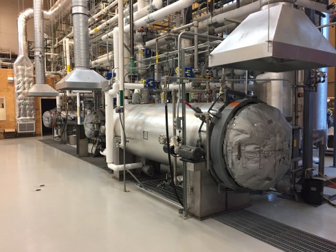

In addition to long-term field testing of industrial wood preservatives, the Forest Product Laboratory conducts research to develop new and improved treatment schedules for a variety of wood species. The FPL's state-of-the-art wood-treating pilot plant, constructed in 2010, offers five different preservative treatment retorts that can accommodate samples up to 12 feet long.
