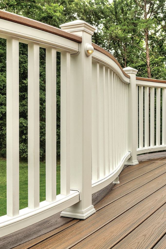

Trex Transcend composite balusters and rails can be mixed and matched to create different looks and are available in seven colors (trex.com).
