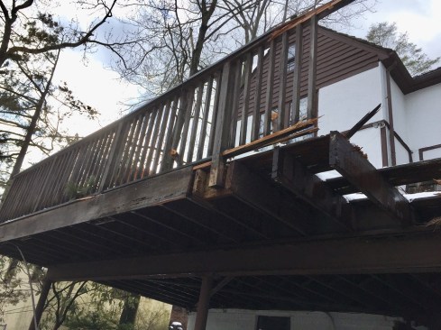

In March of 2018, four nor’easters blew through my home state of New Jersey. At the time, I thought they only ruined my weekend bike rides, but it turned out that one of those bad boys provided my remodeling company with a break from our typical renovation work, which mainly takes place in urban Hoboken. A client we occasionally hear from who lives in the "wilds" of South Orange called and asked us to take a look at her deck, which had been hit by a large oak tree uprooted during one of those storms. It turned out that the damage resulting from the uprooted tree – which took out two sections of rail and damaged five joists – was the least of the deck’s problems; the rest of the deck was rotten to the core. Our client was lucky the tree hit her deck and revealed its other problems before someone was seriously hurt.
Though the original deck sustained damage when a tree fell on it during a windstorm, it was probably due for replacement anyway thanks to sketchy ledger connection details and extensive rot. The columns and W10 steel girder supporting the deck were the only components that were reused.
Robert Corbo Though the original deck sustained damage when a tree fell on it during a windstorm, it was probably due for replacement anyway thanks to sketchy ledger connection details and extensive rot. The columns and W10 steel girder supporting the deck were the only components that were reused.
When I assessed the damage for my client’s insurance company, I focused on the structural integrity of the deck, not on the damaged area, since I didn’t want to be involved in a repair that might make us liable for the entire deck going forward. I thought it likely that the fallen tree had pushed the deck out of square, and that the deck only returned to its original position after the tree had been removed. Because I suspected that this may have compromised the joist/nail connections at the house ledger, in my proposal I provided an estimate for removing the existing deck and building a new one.

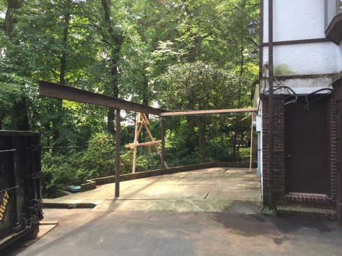

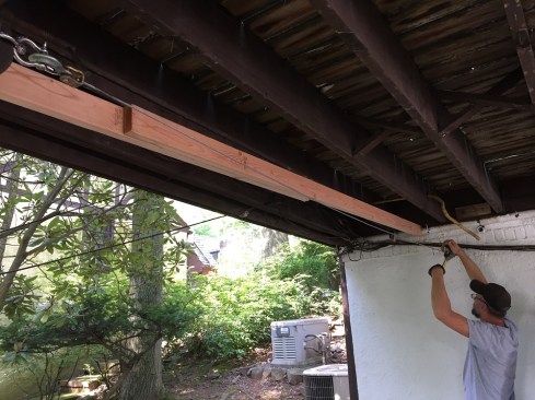

Before we could demo the deck, we had to deal with the electrical service line, which ran from a backyard service pole approximately 35 to 40 feet to the deck. Because we weren’t sure how significant the load was where the cable came in contact with the deck, we supported the service head with a makeshift tripod, then attached it to the steel girder with a C-clamp and heavy-duty rope. Then we attached a cable and turnbuckle between the house and the girder (before attaching the service head), using an eyebolt through the foundation and another C-clamp on the beam. After that, demolition was a piece of cake.
To stabilize the steel girder, the crew braced it with 2x and a cable tensioned by a come-along.
The service drop was temporarily supported by a wood-framed tripod. Note the steel beam cantilever, required to provide access to one of the garage doors at ground level.

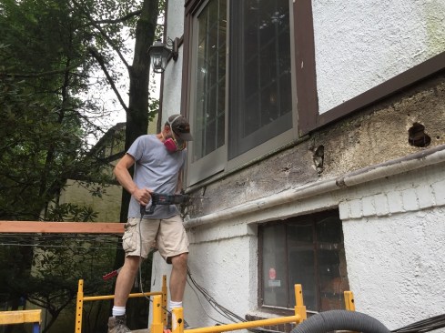

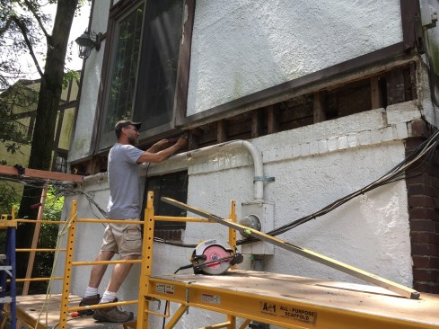

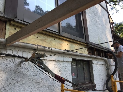

When project manager Danny DoCouto examined the house where the old ledger was attached, he determined that there was no rim joist to which we could bolt a new ledger. It also appeared that a number of areas behind the house’s traditional 3-coat stucco siding where the old deck ledger had been fastened had rotted. We had no choice but to remove the stucco siding down to the framing where the new ledger would be attached.
The ledger for the original deck had just been bolted through the stucco siding, creating pathways for water to penetrate the framing.

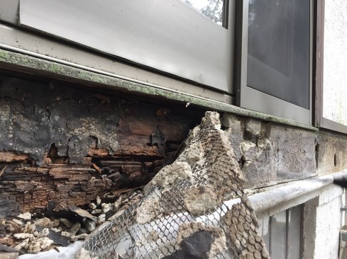

Cutting away the stucco revealed considerable damage to the sheathing and cripple studs underneath the sliding door leading out onto the deck.
We cut through the stucco and wire mesh with a grinder and chipping hammer to remove the stucco and wire mesh, uncovering a balloon-framed system clad with rotten sheathing. Most of the cripples under the sliding door that provided access to the deck were rotten as well.
We pulled off the rotten sheathing and removed the cripples, but rather than replacing them, Danny used treated 2x10s to build up a solid header under the sliders. Where the framing was exposed, we pulled out the old fiberglass insulation and filled the bays with Rockwool Roxul stone wool insulation to provide a fire stop and some protection from air infiltration. Then we installed new ½-inch sheathing to complete the rebuild, giving us a sound substrate for the new ledger.
Because of the water damage, it was necessary to remove some of the framing.
A solid PT header was installed underneath the slider to replace the cripple studs.

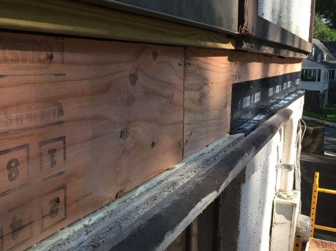

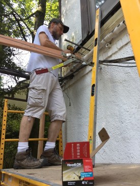

After marking the stud locations on the stucco siding, we covered the sheathing with two strips of 12-inch-wide Vycor SAF flashing. We installed the lower strip first, taking care to lap it over the stucco at the bottom. When we installed the upper strip, we tucked the flashing in as best we could underneath the membrane behind the stucco at the top, and made sure it lapped over the bottom strip. Then we bolted the ledger into place directly into the studs and the header underneath the sliders.
After resheathing, the crew waterproofed the exposed wall with self-adhering flashing tape installed to lap over the stucco cladding.
Finally, it was time to install the new ledger.

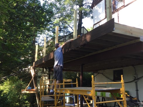

Out-of-Level Girder

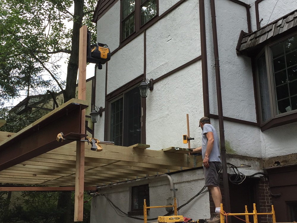

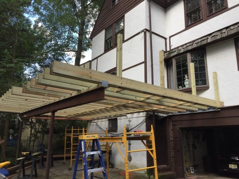

Next, we tackled the 24-foot-long W10 girder, which was cantilevered 8 feet on the driveway side so no obstruction interfered with the access to the three-car garage. We were concerned that it had been compromised, since its cantilevered side had been hit when the oak tree came down on the deck. After some discussion, an engineer who the homeowner had consulted on the project approved it for construction and provided documentation to include in our permit application stating that the existing girder could safely support the proposed loads.

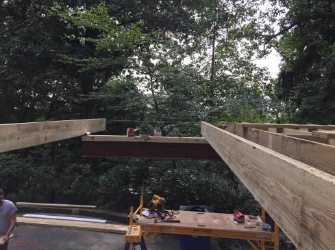

Still, when we checked elevations on the girder and house with a laser level, we discovered that the girder was 2 ¾ inches out of level. Whether the impact of the tree had bent the beam or fatigue was a factor (or both), others who were higher up the food chain had approved the girder for construction. So rather than continuing to speculate, we concentrated on finding a solution for installing joists on the out-of-level girder.

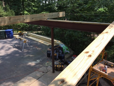

After the steel girder was cleaned and primed, it was capped with a strip of flashing tape and a PT 2x6, which was bolted to the top flange (above). Because the girder was out of level by 2 3/4 inches from end to end, a string was pulled to establish a level line, and notches were cut into the plate as needed to bring the joists flush with the string (right).
The low point of the girder was the cantilevered section, so an additional 5/4 x 6 plate was screwed to the 2x6 plate to shim the joists to the proper elevation.
Once the new ledger and joists were installed, it was full speed ahead on the rest of the deck rebuild.

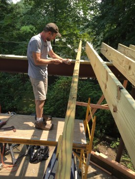

After scraping and priming the girder, we applied Vycor flashing tape to the top of the beam and bolted a PT 2x6 plate in place. We placed the first joist on the high side of the girder, where the joist was dead level. Because we wanted to pitch the framing slightly from the ledger to the outside edge of the deck, we notched the 2x6 plate with a circular saw and chisel so that the joist was recessed into the plate by ½-inch.
Next, we installed a second joist 16 feet away from the first, where the girder started its cantilever. This joist required a 1-inch-thick shim instead of a notch to maintain the same pitch. We then pulled a line between the two joists, so that we could set the remaining joists, with the line dictating how much shimming or notching would be required to bring each joist up to level.
To match the string height, we ended up recessing the first four joists, while the next two were installed flush with the plate. We had to shim the next six joists. Finally, before installing the last joists on the cantilevered portion of the girder, we screwed a 5/4 x 6 treated board to the 2x6 girder plate to reduce the size of the shim needed under each joist. Then we shimmed the final joists to their proper height, using a 6-foot level for reference.
