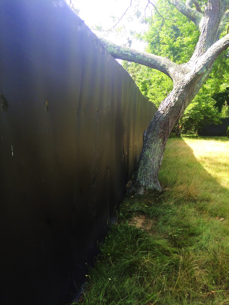

A wooden fence does not have sufficient STC by itself, so it should be lined with an acoustic barrier having an STC of at least 30. Typically, we use a mass-loaded vinyl barrier, such as the SoundSense NoiseOut2 or the equivalent. (If the barrier is not UV-resistant, be sure to keep direct sunlight off it.) A mass-loaded vinyl barrier works by providing a dense, resilient layer as well as a surface free of voids to block the sound. This approach lets the client and contractor choose the fence style they like and then line the fence with a vinyl barrier (usually black). In order to have sufficient transmission loss in the lower frequency of car exhaust, use a mass-loaded vinyl with a weight of 1 1/2 pounds per square foot or greater. Most loaded vinyl products are lighter, so be sure to choose the heavier product (for more about this material, see “Retrofit Soundproofing,” Jan/15).
