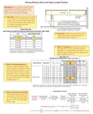

Navigating Table R507.5(5) “Joist Span Factors for Calculating Effective Deck Joist Span”
Table R507.5(5) is the engine behind the effective deck joist span length. It’s a workaround used in conjunction with the beam tables that adjusts for the lighter load a beam has on it when there is no joist cantilever or when a joist cantilever is shorter than the maximum allowed.
The left column of Table R507.5(5) is a series of fractions. The column is labeled “C/J,” with C being the actual joist cantilever length and J being the actual joist span length.
The right-hand column lists joist span factors. These are the numbers you multiply the actual joist span by to determine the effective deck joist span length on the beam table. You’ll notice that most of the joist span factors are numbers less than 1. So when you multiply the actual joist span length by a number less than 1, the resulting effective deck joist span length measurement will be shorter. When that measurement is applied to the beam table, it will result in a greater beam span than you get when you use the actual joist span length.
It’ll make your head spin the first few times you use it. I found the trick is to avoid confusing the decimal values in the left and right columns.Below, you’ll find an example of the steps involved in solving an “Effective Deck Joist Span Length” problem. The deck will be built with 2x10 SYP deck joists with a 14-foot span between the beam and ledger, and a 1-foot-1 1/2‑inch cantilever (the fact that the joists are 2x10 SYP is irrelevant to the calculation).
After determining the joist span factor and calculating the effective deck joist span length following step 1, refer to the beam span table to find the maximum beam span allowed. In this example, the effective joist span length is 10 feet 15/16 inches, which I rounded up to 10 feet 1 inch.
Unless you’re lucky, the effective joist span calculated won’t match one of the column lengths listed, in which case you have a few options. The simplest is to round up to the column with the next longer length, in this case from 10 feet 1 inch to 12 feet, then read the maximum deck beam span length associated with the beam size you’re planning. For double 2x10 southern pine beams in this example, that measurement is 7 feet 4 inches, as shown (Option A below).

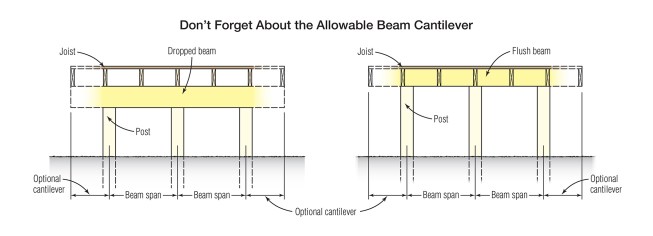

Many deck builders don’t realize that beams can cantilever beyond the end posts. The maximum cantilever distance is one-quarter of the beam span between the end post and its neighbor post. Beam span is measured between the centers of support columns or posts. For example, the maximum cantilever of a beam with an adjacent span of 8 feet 7 inches would be 8 feet 7 inches ÷ 4 = 2 feet 1 3/4 inches. The cantilever span is measured from the center of the post to the outside end. Sometimes, cantilevering the beam at the ends of a deck will allow you to eliminate a footing and post compared with installing footings at the ends of a beam.

Interpolation. If you want a more precise measurement of the beam span, you can interpolate between deck-beam-span values that fall between the next lower and next higher columns associated with the effective deck joist span length you came up with. In this example, again, you would be using the 10- and 12-foot joist-span columns.
In cases where the effective joist span falls less than halfway between the 10-foot and 12-foot joist-span columns, you can perform an analog interpolation (Option B below). This is a bit like rounding up, but rounding up to a column that could be in the table if it were graduated in 1-foot increments instead of 2-foot increments. An analog interpolation could even divide the values between the two joist-span columns by quarters rather than halves pretty easily.
In this example, the effective joist span (10 feet 1 inch) is rounded up to the next foot length (11 feet), which is halfway between the 10- and 12‑foot joist-span columns. Then split the beam length halfway between the spans listed (8 feet 0 inches and 7 feet 4 inches). The result is a beam span of 7 feet 8 inches.
For the mathematically inclined, you can actually calculate the interpolated value following the formula in the example shown here (Option C below). In this case, the calculated maximum beam span is 7 feet 11 11/16 inches.

Sizing beams for a given length of deck joist is a multistep process. First, you must determine the effective joist span length following steps 1A and 1B above, and then refer to the appropriate section of Table R507.5 to round up (Option A), perform a quick analog interpolation (Option B), or mathematically calculate the interpolation (Option C) to find the maximum deck beam span.
As you can see, the difference between the estimated maximum beam span (7 feet 4 inches), the analog interpolation of the beam span (7 feet 8 inches), and the calculated interpolation of the beam span (7 feet 11 11/16 inches) isn’t huge. But the ability to eke out a few extra inches of span (and to be able to explain to your inspector how you did it) could make a difference in your next project.
