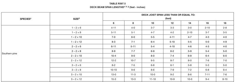

Spans for 2x6 through 2x12 single-ply beams have been added to Table R507.5 in the 2018 IRC. Expect to see a similar table in the next version of DCA6. Table excerpted from the 2018 International Residential Code; Copyright 2017 Washington, D.C.: International Code Council. Reproduced with permission. All rights reserved. www.ICCSAFE.org

The 2018 edition of the IRC built on this momentum by adding some flexibility with single-ply beams in Table R507.5 Deck Beam Span Lengths. This key beam-span table (which will appear in the yet-to-be released 2018 edition of DCA6) has five new rows for 2×6 through 2×12 single-ply beams. The spans aren’t huge, but they help the IRC be what it is supposed to be—a minimum standard.

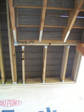

The double-ply beam supporting this stair landing is structurally unnecessary and could be replaced with a single 2x6, according to Table R507.5 in the 2018 IRC.
Glenn Mathewson
The double-ply beam supporting this stair landing is structurally unnecessary and could be replaced with a single 2×6, according to Table R507.5 in the 2018 IRC.
Intermediate stair landings are a prime example of a place where a single-ply beam can be an appropriate framing solution, even for above-code builders. In most cases, a two-ply beam at the front of a stair landing isn’t structurally necessary, because (according to Table R507.5) a single-ply 4-foot-11-inch 2×6 beam can support joist spans up to 6 feet.
This prescriptive solution is also good news for folks who are living on a budget and might prefer a small deck instead of a cheap concrete paver patio. The single-ply beam spans from the IRC’s prescriptive table allow for a simple 7×7 deck or 8×8 deck with cantilevered joists using only single members, a ledger connection, and two footers. That’s an economical solution.

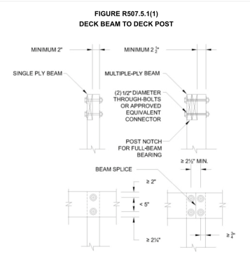

The 2018 IRC also includes a post-to-beam connection detail for 4x4 posts and single-ply beams. Table excerpted from the 2018 International Residential Code; Copyright 2017 Washington, D.C.: International Code Council. Reproduced with permission. All rights reserved. www.ICCSAFE.org
ICC
The 2018 IRC also includes a post-to-beam connection detail for 4×4 posts and single-ply beams. Table excerpted from the 2018 International Residential Code; Copyright 2017 Washington, D.C.: International Code Council. Reproduced with permission. All rights reserved. www.ICCSAFE.org
If you’re going to have single-ply beams for budget decks, you might as well have a notched and bolted post-to-beam connection, especially since hardware manufacturers don’t offer much in the way of hardware that is designed for single-ply beams. The problem with that plan is that the 2015 IRC only offers a notched post-to-beam connection detail for a 6×6 post to a two-ply beam, which calls for a 2 1/2-inch flange beside the notch to bolt the beam to. However, only a 2-inch flange is left when a 4×4 is notched for a single-ply beam. Fortunately, the 2018 IRC takes care of this problem by including a new detail for notched 4×4 posts and single-ply beams, which specifically allows for the narrower, 2-inch flange.
