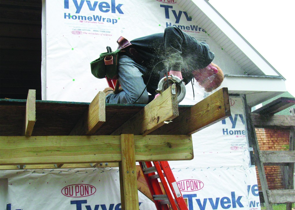

Measuring Joist Span
Before you can apply the table, you need to know how the deck joist span is measured. Figure R507.6 “Typical Deck Joist Spans” includes four illustrations depicting the joist-span measurement points for two decks attached to a wall by a ledger—one with a flush rim beam and one with joists cantilevering over a dropped beam—and two free-standing decks—one with flush beams and one with cantilevers. The important thing to note is that the joist span is measured from the center of the joist bearing at each end. Some people confuse “joist span” with “deck depth” (the distance from exterior wall surface to the outside of the rim joist).
If the deck is framed from a ledger to a flush rim beam at the outside, then the span measurement is taken from the center of the joist hanger at the ledger end and the center of the joist hanger at the beam end. Many joist hangers used on decks have a 2-inch-deep saddle that the joists rest on. So a deck with a two-ply flush beam at one end and a single-ply ledger at the house end essentially “gains” 4 inches of deck depth at the outside end and 2 1/2 inches at the inside end—a total of 6 1/2 inches. This may seem like an insignificant distance, but using deck depth instead of joist span may lead you to look down the wrong joist-span column and size the beam with shorter spans than necessary (more about beam sizing in a follow-up article).
On decks where the joists cantilever over a dropped beam, the span measurement is taken from the center of the joist hanger at the ledger end to the center of the beam. The cantilever portion of the joist is not counted as joist span. The depth of a deck with cantilever joists can be several feet greater than the joist span due to the cantilever portion.

Measuring Joist Cantilever
The cantilever is measured from the center of the beam to the outside edge of the cantilever, but where that point is can be confusing. The code figure depicts only one of several possible details: the measurement point at the outside face of the rim board—which is also where the figure depicts the edge of the last deck board. If the deck board overhangs past the rim board, then should that projecting edge of decking be the measurement point for cantilever span? What if a fascia board is installed over the rim board and then the decking overhangs the fascia?
In practice, someone could stand on a decking board at its outer edge and thereby put a load that carries back to the deck joists. I would err on the side of being conservative here and measure the cantilever to the outer edge of the decking and not just to the face of the rim board.
We’re only talking about an inch or two between a fascia board and decking overhang, but sometimes that may be just the distance you need to start and end with full deck boards at the outside and along the wall. It may be worth checking with your local building department to see if it counts the overhanging decking as part of the cantilever span.
