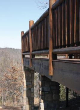

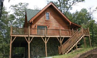

Don't be afraid to use masonry and rock as posts (Figure 2). This can be more expensive, but it creates a substantial base for the deck that's in keeping with the rustic style. It looks particularly nice when the foundation or basement is also faced with stone.
Figure 2. Facing columns with native stone is a great way to tie the deck to the landscape.

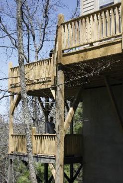

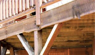

When I use traditional 6x6 treated posts, I make them look more rustic by getting creative with angle braces. When it's possible, I like to put angle braces on a 60-degree angle from the post instead of at the common 45-degree angle (Figure 3). Not only does this provide the look of a timber-framed structure, it has structural benefits, as it pushes the brace farther down the post and stiffens the post closer to its middle.
Figure 3. Setting braces at 60 degrees to the posts mimics old timber-frame construction.

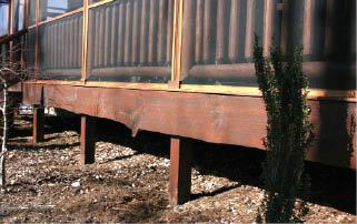

Carving the edges of the braces with a draw knife is another rustic touch that works well on the posts too (Figure 4). Get everything built and put together first, then go back and carve your edges. That way, you aren't carving where the brace meets the post, creating a funky spot.
Figure 4. Randomly chamfer the edges of posts and braces to create a time-worn look.

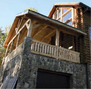

Tree trunks of 12 inches in diameter or more make for great posts (Figure 5).
Figure 5. Large-diameter posts, or even tree trunks, make for a distinctly rustic appearance. Photo by: Kim Katwijk

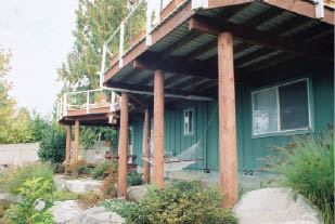

Make sure you use a proper anchor, or better yet, a small base column covered with rock (Figure 6), because usually this wood is not rated for ground contact, and this will help keep the post from rotting. Always check with your local building inspector for allowable designs and materials.
Figure 6. Stone bases not only tie wood columns to the ground, they elevate the wood so there's less chance of it rotting.

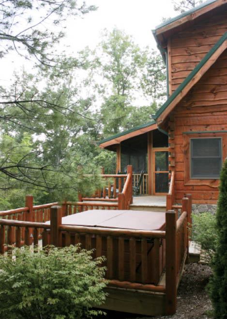

Another terrific and fairly easy addition to a rustic deck is precut round railing (Figure 8). This is usually made from white cedar and sold in 8-foot-long sections, but most producers will sell custom lengths for a small upcharge. I recommend buying the top and bottom rails without picket holes drilled in them by the manufacturer. This step is pretty simple to do on site, and you come out with much better spacing. A draw knife can be used to shave off any unwanted spots and pretty much reduce the amount of sanding to zero.
Figure 8. White cedar log railings are available through log-home distributors.
This type of railing will cost at least a third more than traditional treated-lumber railing. A great source for the material is log- or timber-home producers. They typically have very good pricing and will ship to the job site. They are also usually flexible enough to customize any sections you need, including long runs for stairs.
