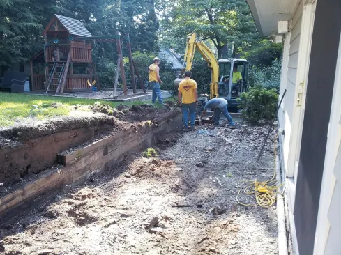

As I do a lot of unusual deck projects, I wasn’t surprised to get the call for the one pictured here. The challenge was that the rear door of the house was 3 to 4 feet below the small backyard. Previous owners had terraced the yard with an old-fashioned 6×6 railroad-tie retaining wall, but it was poorly drained and was showing signs of age. It’s likely that it was installed at the same time as an existing 30-year-old wood deck, which the owners wanted to replace with a larger one that would provide more entertainment space and a route to the rest of the backyard.

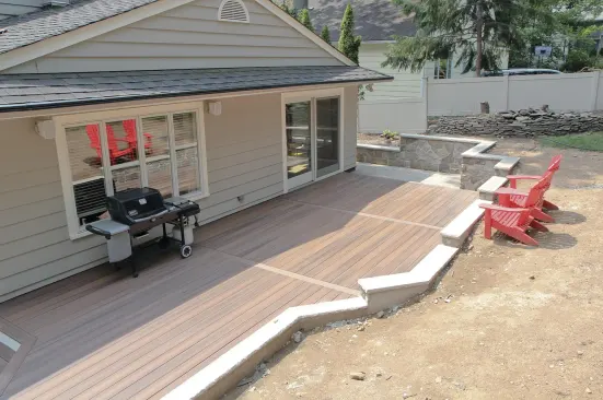

The design we implemented here was similar to the existing layout, but I was able to enlarge the area a considerable amount, add some much-needed drainage, and create a more durable and better-looking retaining wall.

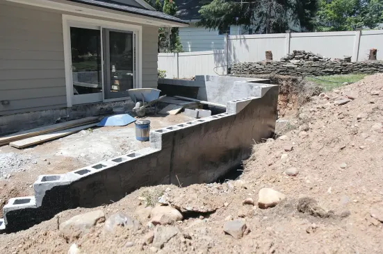

The heart of this project is the stone-faced concrete-block retaining wall. It serves a dual purpose: It creates a sloped terrace and it supports the outer edge of the deck in lieu of traditional footings. While we could have installed a retaining wall made of interlocking modular block and supported the deck on separate footings, that wasn’t the aesthetic the clients wanted — in fact, they absolutely rejected the idea. Because the retaining wall was to be such a visible part of the project, they wanted it to have the look of natural stone.
I ended up designing the retaining wall much like the basement of a house, with a poured concrete footing and a stacked block wall. The blocks would then be covered by a cultured stone veneer. My engineer agreed that this approach would not only work, but work exceptionally well.

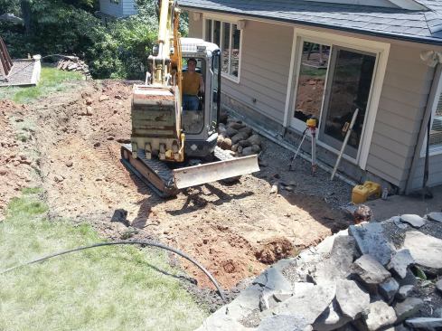

My crew tore out the old deck, then an excavation contractor dug out the area. This was no simple task because the small lot had limited access for moving machinery and dirt in and out. Since there was so little room to work and we’d be replacing a fair amount of the excavated dirt with gravel for drainage, we trucked out the majority of the dirt during the initial excavation.

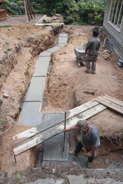

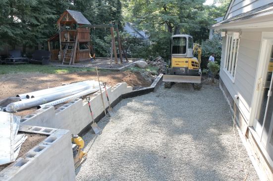

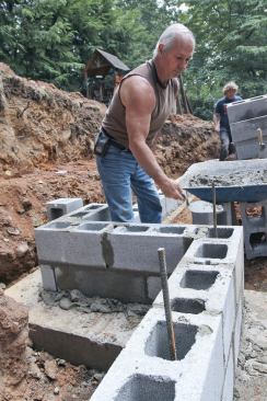

My mason contractor formed and poured a 12-inch-by-24-inch footing along the length of the wall. Ten-inch hollow concrete block was then set on the footing. Rebar was pinned into the footing every few feet and the block cavities containing the rebar were grouted full, per the engineer’s instructions. The next day, the mason plastered and subsequently tarred both sides of the retaining wall prior to backfill. To provide the excavator access to get his machinery back up the grade to complete the backfill process, a section of the wall was only partially blocked up.
Before backfilling, the excavator installed 4-inch perforated drain pipe on both sides of the wall at the footing. Landscape cloth and 3/4-inch clean gravel were installed above it to facilitate drainage. A third drain pipe was placed near an existing dry-laid stone wall where a box drain received surface water running down the lawn. All three drain pipes were tied together with solid pipe and run downhill toward the front of the property where we were able to deal with runoff more effectively than on the steep slope of the backyard.

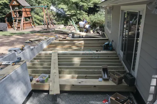

Beneath the area where the deck was to be built, the excavator graded the existing soil away from the house foundation and toward the retaining wall where the perforated pipe was installed. We installed landscape fabric and enough 3/4-inch clean crushed stone over the graded soil to give it the appearance of being flat and to give the pressure-treated deck frame as much room as possible to breathe and dry out.

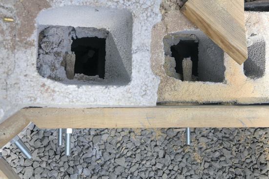

We attached the deck ledger to the existing rim joist using LedgerLok screws (FastenMaster; 800/518-3569, fastenmaster.com). The ledger at the retaining wall was fastened with 1/2-inch galvanized threaded rod and HY-20 two-part epoxy and screens (Hilti Corp.; 800/879-8000, us.hilti.com). This was familiar technology for us — my company frequently attaches deck ledgers to hollow concrete-block house foundations using these chemically anchored threaded rods, with my engineer’s approval.

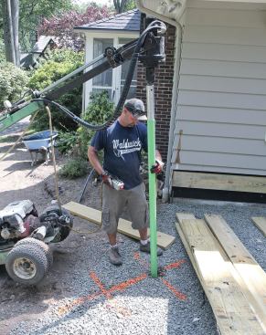

Although the deck is primarily supported by the house and the retaining wall, the design required that a drop girder be installed on one side, near the staircase. To support this beam, we installed two helical piles during the framing phase (see “Helical Pile Deck Foundations,” May/June 2012).
The deck was otherwise typical — 2×10 southern-pine joists 12 inches on-center were attached with joist hangers to both ledgers. I added blocking to support two seam-board details that eliminated the need for staggered butt joints in the decking. We installed the decking — Fiberon Horizons Tudor Brown (800/573-8841, fiberondecking.com) — with Tiger Claw TC-G hidden fasteners (FastenMaster; 800/518-3569, deckfastener.com).

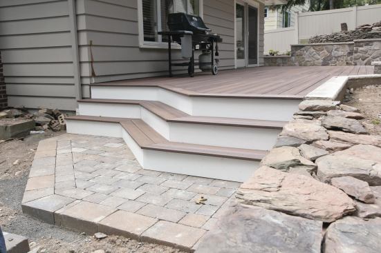

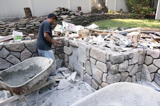

After the decking was installed, the mason returned to install the cultured stone veneer on the retaining wall and on an existing brick wall that ran along the side of the house. A 2-inch-thick natural bluestone cap finished off the top of the wall. Concrete pavers serve as a stair landing on one side of the deck and as an entrance on the other.
