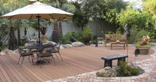

The pool-top decks that Getz builds conform to the shape of the pool and are set flush with or slightly higher than the surrounding surface. Rather than measuring and cutting each deck board to fit within the pool perimeter, a time-consuming and tedious process, he installs the decking with the deck raised a few inches, running the boards long and cutting them to shape in place. Afterward, he drops the deck into the hole for a perfect fit.
Another important consideration is keeping the underdeck area dry; even though it is a pool, standing water would be a problem. Getz installs a pump so that any water that falls through the gaps in the decking is automatically pumped out to the backwash line on the pool filter. Should a homeowner need to service the pump, a built-in hatch allows access to the area below the deck; homeowners can also store pool equipment and other items there in waterproof containers.
The deck and the framing can be removed if the homeowner – or a future buyer – wants to reopen the pool. At that time the pool will likely need to be resurfaced, but the framing doesn’t do any damage to the pool structure. – Laurie Elden
