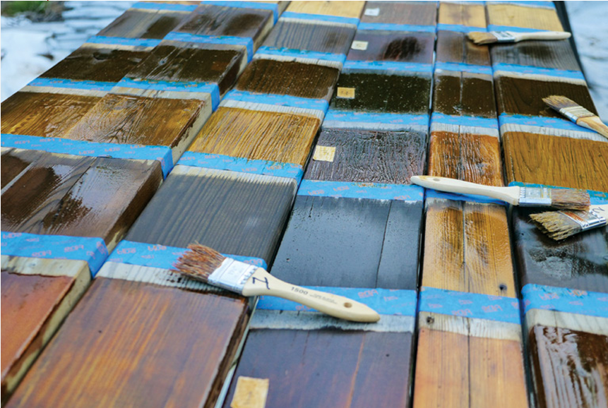

All the boards started off as 16-footers, but were cut in half for ease of handling. We used blue painter’s tape to divide the boards into twelve sections, applied the finishes, then moved the boards inside our open-air shop to dry.
Deck boards were divided into sections with masking tape, and finish was applied to each section per manufacturer recommendations. Stains were tested on (left to right) lodgepole pine, ACQ-treated southern yellow pine, micronized CA-treated southern yellow pine, ipe, western red cedar, and ACQ-treated hem-fir decking.
Kim Katwijk Deck boards were divided into sections with masking tape, and finish was applied to each section per manufacturer recommendations. Stains were tested on (left to right) lodgepole pine, ACQ-treated southern yellow pine, micronized CA-treated southern yellow pine, ipe, western red cedar, and ACQ-treated hem-fir decking.

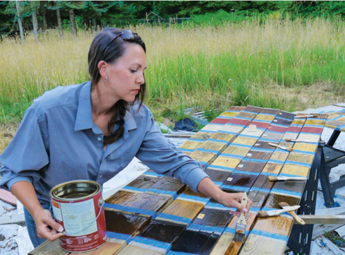

Application
We applied each sample to each of the six boards following the manufacturer’s application instructions. In cases where the manufacturer specifically required two coats, we applied them. Then we allowed the finishes to dry for two weeks prior to putting them out in the weather. During the drying period, the temperature hovered between 58°F and 60°F during the day and 48°F and 50°F at night, well within the drying conditions specified by the manufacturers.
Some deck builders don’t like to fuss over the finish, and they leave it up to the homeowner or a painting contractor. For others, applying the finish is an important final step in the total deck-building process. To give both groups an idea of what to expect, we carefully read and followed the application instructions for each sample and rated each one on a simple scale:
Easy = Send out a monkey with a paint brush at any time of the day and the deck will look great!
Medium = The finish needs to be applied at just the right temperature, with no direct sunlight; each board must be stained end-to-end in a continuous stroke to prevent lap marks.
Difficult = Even after doing all the tricky stuff, you need to wipe off the excess stain 20 minutes after application—which isn’t difficult on a small sample, but is no fun on a large, wet deck.

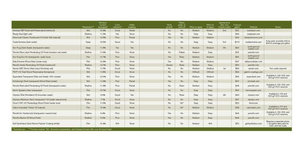

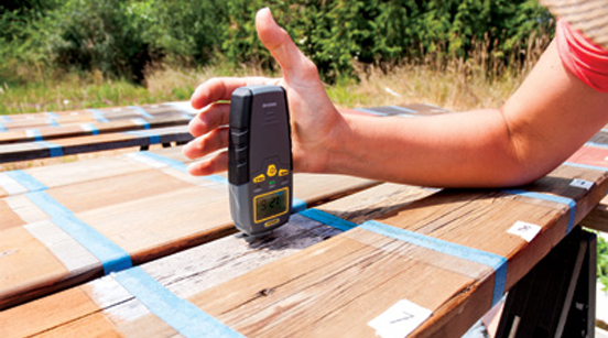

Moisture content was tested after soaking the boards for three days, then allowing them to dry for four hours. The results are noted on the chart accompanying this article.
Kim Katwijk Moisture content was tested after soaking the boards for three days, then allowing them to dry for four hours. The results are noted on the chart accompanying this article.

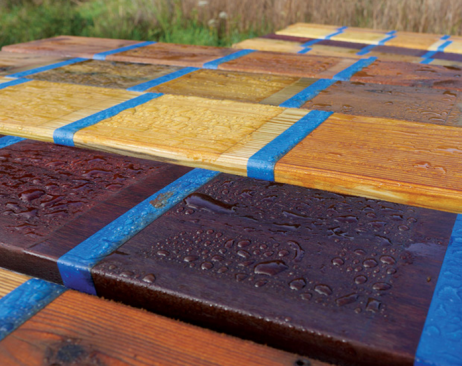

Moisture resistance. During our testing, the boards were sprinkled by a short, light rain shower, which gave us a pretty good indication of how well the finishes repelled moisture. We observed the boards for a half-hour after the rain to see if water would bead up, or if it would just soak into the wood. Though unscientific, this seemed to demonstrate dramatically how well each finish was protecting the wood underneath it.
After our initial observations, we ran a sprinkler and exposed the boards to moisture continuously for 72 hours. We allowed the boards to dry for four hours, then tested moisture content with a General Tools MMD4E pin-type moisture meter. We took three readings for each stain on each board, then averaged the readings together. We also calculated an overall average from the readings of each stain on all of the species.
Curiously, our initial observations about water beading didn’t seem to correlate to the measured moisture content. Nor did the presence (or absence) of beading indicate anything about the ability of the finish to retain color, as noted on the chart.
Mold. We also carefully visually examined each sample for mold and mildew. Some boards grew mold all over, some grew a few small spots, and some did not grow any mold at all. For example, while the old cedar was especially susceptible to growing mold, some stains, such as our top choice, Cutek, inhibited the mold from growing even on that board.
Difficulty of re-staining: Because of the high rate of failure, especially with the green wood samples, most of the test boards needed to be scuff-sanded before being refinished. Less than a handful needed only to be cleaned off for us to reapply the stain. Again, we rated the finishes according to our easy/medium/difficult scale.
