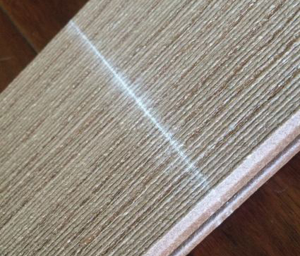

1. Instead of using a chalk line to mark cut lines and fastener locations on your decking, try using a wet dry line instead. Even though blue and white chalk aren't supposed to be permanent, I always find that it takes a long time for the lines to disappear. So I grab an unchalked line and leave it soaking in a pail of water, simply pulling it out as needed to snap the next line, which will evaporate and disappear without a trace in just a few minutes.

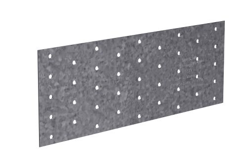

2. If your hammering skills are a little off and you are leaving pecker marks on that expensive trim or decking, take a Simpson Strong-Tie TP tie plate and drill out one of the holes so that it is large enough to slip over the nail head. Or cut a V-shaped slot along one edge. Either way, the plate will protect the wood from hammer misses. This is a good trick for newer members of the crew.

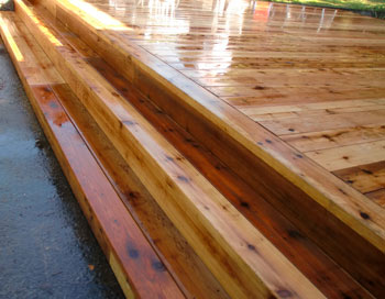

3. If you’ve just finished installing cedar decking and it’s a late summer afternoon, wash it off so that it’s still dripping wet when the customer comes home. The deck will look fabulous and very inviting, especially on a hot summer evening.
