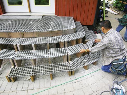

Tile is tough but has little structural strength. It needs to be well supported by a stable substrate that can withstand 300-pound concentrated loads with minimal deflection (see Substrates and Deflection, facing page). Plywood and concrete are conventional substrates, but I’ve seen too many problems—caused by moisture getting trapped underneath the tile—on exterior tile installations using them. A few years ago, looking for a better alternative that would also allow water to drain through the assembly, I began installing deck tiles over McNichols square-mesh molded fiberglass grating panels instead.
I was familiar with these waffle-like grating panels from my years spent in heavy commercial construction, where they’re often used for catwalks and scaffolding. The panels are available in different sizes and thicknesses, but I typically use 4-foot by 12-foot by 1-inch-thick panels with a 1 1/2-inch-square grid. They’re heavy (about the weight of a sheet of 3/4-inch-thick MDF), and cost about $333 per panel at my local distributor. They’re tough as nails and very stiff (you can find load tables for both concentrated and uniform loads on the manufacturer’s website).

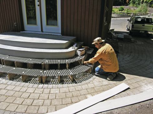

It’s easier to install stone or tile on a rectangular deck than on a curved one, but it’s certainly possible to tile a curved deck. The design shown here, for example, is an ellipse with the sides squared off (for more about how to lay out an ellipse, see “Building an Elliptical Deck,” May/June 2012). The three steps wrap around the deck, rounding off the corners and keeping the elliptical shape to give the small deck a unique look.

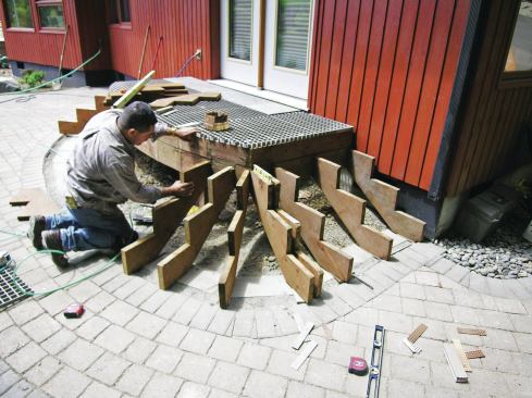

We framed the 4-foot-6-inch by 10-foot-8-inch deck our standard way, with 2×6 PT joists 12 inches on-center attached to the deck ledger at the house and bearing on a 4×6 beam. Since the frost depth in this area is only 12 inches, we supported the beam with three 4×4 posts resting on 12×12 fixed saddle piers.
We ran the joists long, laid out the ellipse, then cut each joist to form the deck’s elliptical shape. We installed blocking between the joists to form the rim joist, then nailed and screwed 2×6 drop blocks to the back side of the rim blocking and outside joists. We fastened more blocking to the drop blocks to provide support for the stair stringers. To limit deflection and prevent cracks or breaks in the stone, I installed extra stair stringers and additional blocking to support the edges of the grating.
The fiberglass grating panels can be cut with a circular saw to fit any shape. They’re installed with proprietary stainless steel clips that are wedged into the grid squares, then fastened to the framing with stainless steel screws. This leaves the top of the grate perfectly smooth and ready for tile.

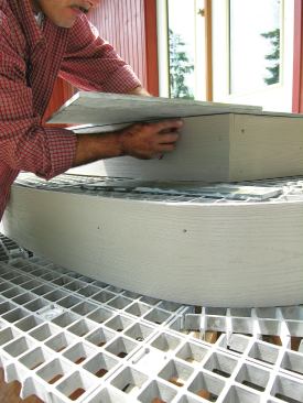

I used gray 1/2-inch Azek trim boards as the fascia on the stair risers. To bend some of the pieces around the tight corners of the ellipse, we had to apply heat with a heat gun to make the pieces more flexible.

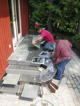

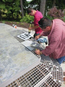

Careful layout is one of the keys to a successful tile installation. On this project, we made sure that the 1/2-inch-thick by 16-inch-square natural slate tiles on the two outside edges would be even, and that there would be a full stone tile at the center front edge. That determined the position of all the remaining tiles, including the 6-inch-wide trim pieces at the wall.

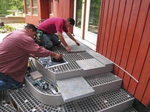

Instead of setting the slate in mortar, we glued the tiles to the grate. We’ve tested and used many different adhesives, and have had good success with Chem Link M-1, a polyether structural adhesive sealant. We like this water-cured, low-VOC adhesive because it doesn’t shrink and remains very flexible.

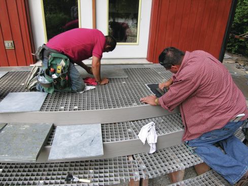

For best adhesion, the tile needs to be as clean as possible. First, we washed and dried each tile to remove any stone dust. Then we wiped the backs of the tiles with denatured alcohol to remove any oils or dirt before applying the adhesive.
We applied the glue to the tile using a caulk gun, then spread it out with a 1/8-inch V-notch trowel. The cured glue is tenacious, so we left about a 1/2-inch-wide glue-free margin on all sides of the tile to save a lot of messy clean-up time later on.

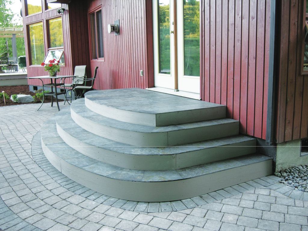

Where tiles needed to be cut to fit the edge of the elliptical shape of the deck, we simply dry-fit the tile, scribed a line on the underside following the edge of the riser, then cut the tile to the line with our wet saw. After the tiles were installed, we smoothed out the cut edges and eased the corners using an angle grinder fitted with a diamond blade.
This is not a “by-the-book” construction method, but I feel very confident in recommending it. The deck shown here is about 8 years old and looks as good as the day we built it, with no cracked or popped tiles.
