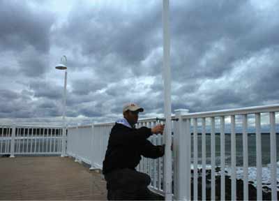

Seaside decks experience the most extreme weather, and more often than not they will be wet. Most customers don’t have time to paint or stain their decks and don’t want to pay a professional once a year to do it for them. I always recommend using low-maintenance decking and railing material, like PVC, or exotic hardwoods, like ipe (Figure 9).
Figure 9. The harsh sun and regular moisture take a big toll on decks built on the coast. Low-maintenance decking and railing are easy upsells in this environment.
