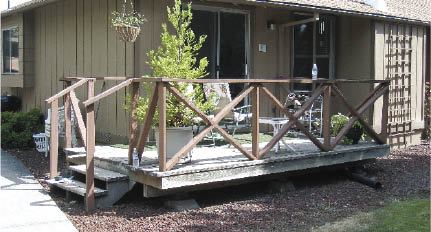

I have to admit, when I was hired last October to replace a dilapidated deck and give a small adjacent one a face-lift — a welcome job in light of my suddenly dormant writing career — I was nervous. While I’d been a carpenter for 12 years and spent the intervening years working at construction magazines, I hadn’t built a deck since Ronald Reagan was president. Back then ledgers were nailed, joists weren’t always pressure-treated, decking was redwood or western red cedar, and guardrail posts were bolted or lagged to the rim and side joists with no regard for reinforcement.
To get up to date, I talked with the local building department and studied its literature — though no permit was required because the decks would be less than 30 inches high. I crunched through Simpson Strong-Tie’s C-2009 connector catalog and its Deck Framing Connection Guide. I read books and magazine articles and watched a video.
But there’s no substitute for on-the-job retraining. For the new deck, I used pressure-treated framing lumber, of course, and installed composite decking and western red cedar guardrails. The refurbished deck got the same decking and guardrails plus some extra joists to support them. Nothing exotic here, but careful attention to detail would help make the decks pop. That was important because the deck side of the house serves as its informal main entrance. The bottom line? The customers are happy, and I’m anxious to build on my experience. Here are some of the things I learned.

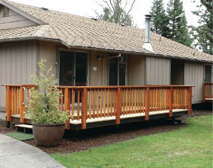

Composite Thinking
Having lived with redwood decking for years, the homeowners chose to switch to 1×6 EverGrain composite decking (Tamko Building Products; 800/253-1401, evergrain.com) so the deck would require less maintenance — aware that they still would have to clean it regularly. They settled on the cedar color from the Classic Collection, hoping the light hue would help prevent summer overheating.
I installed the decking working from the rim joists toward the house to ensure that I would have full-width boards above the rims for easy notching and fastening and good looks (Figure 2). I found no drawbacks to this approach and will repeat it next time.
Figure 2. The guardrail posts anchor to the outside of the rim joists, so only one course of decking had to be notched at the rims. Installing the decking from the rim toward the house placed a full-width board above the rim for easy notching and attachment
Like many of its competitors, EverGrain recommends a minimum side-to-side spacing of 1/8 inch. I could imagine 1/8-inch gaps quickly filling with dog hair and dirt, so I called EverGrain’s technical services department about it. I happened to connect to someone who had installed the decking on his own house with the boards spaced 1/8 inch apart and has regretted it ever since because the gaps clog and are hard to clean. So I spaced the boards using nominal 1/4-inch plywood spacers for consistency (Figure 3). I rounded the ends of the boards up top with a trim router for a finishing touch.
Figure 3. EverGrain deck boards must be spaced at least 1/8 inch apart from side to side, but this larger, 7/32-inch gap is less likely to clog with debris. GRK’s star bit drove more than 1,000 Kameleon composite-deck screws with no cam-out.
The EverGrain installation manual warns that composite decking feels more flexible than wood, mainly during summer heat. For a more rigid feel, it suggests reducing the maximum recommended joist spacing by 4 inches. Well, my 2×6 joists are spaced the maximum recommended 16 inches on-center on the new deck and 12 inches on-center on the refurbished one. Although the joists span about 6 inches farther on the former than on the latter and add a cantilever, this still sets up an easy, if unscientific, comparison.
Maybe this summer we’ll wish all the joists were spaced 12 inches on center, but as I write this it’s 54° at the site and Joe — a tough customer who weighs 215 pounds — just reported that he doesn’t feel “any spring at all” when walking on either deck and can feel just a slight difference between the two decks when he jumps up and down.

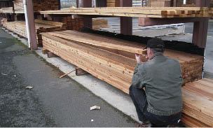

Although this project was built on a modest budget, I treated the western red cedar guardrails as outdoor furniture. With that mind-set, I sanded all the parts before assembly and used type 305 stainless steel screws throughout because they’ll be virtually immune to corrosion and won’t cause ugly black streaks on the cedar, the way galvanized fasteners tend to. Maybe that’s overkill, but my customers are calling the finished product “breathtaking” and, trust me, will take great pains to maintain the finish. In fact, they applied oil-based Superdeck “Century Redwood” exterior transparent stain and sealer (Duckback Products; 800/825-5382, superdeck.com) to the parts as fast as I installed them to prevent the intermittent raindrops from touching bare wood.
I even took extra pains at the lumberyard, which let me hand-pick my guardrail stock and 20-foot rim joist (Figure 4). That burned a couple of hours, but it turned out to be a key step because the quality of the western red cedar was wildly inconsistent from one stack to the next. For instance, I needed several 10-foot-long 2x6s, but the 10-footers were gnarled. The 20-footers stacked nearby were pristine, which solved the problem.
Figure 4. Hand-picking western red cedar at the lumberyard made it possible to build a furniture-grade guardrail.

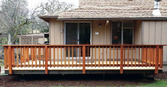

Guardrail-post connectors such as I used on this deck can make it challenging to space posts evenly. Instead of uniform post spacing, I focused on a symmetrical layout. From either end, the next post is 48 inches in. The two center spaces, however, are 50 1/2 inches. That meant if I maintained a consistent baluster spacing, the gaps on the opposite sides of the second post from each end would be unequal (photo, left). In the end, however, everything looks fine, because of the overall symmetry (photo, right). Next time I won’t worry about it.
Guardrail Posts Out, Rails In
In the past, guardrail posts were frequently notched at the bottoms, but those notches can eventually cause cracks that weaken the posts. Conscientious builders no longer do it.
Posts are often attached to the inside face of the rim and side joists. That way, you can use single posts at the corners and shim posts inconspicuously into perfect alignment. It’s also the only way to accommodate the post sleeves included with many synthetic guardrail systems. However, it normally forces you to notch two courses of decking above the rim to fit around the posts.
On this job, I installed my posts on the outside because I like that look. It moved the guardrail 5 inches out, which added 26 square feet to the decks; another benefit to this approach was that I had to notch only one deck board above the rims. The trade-off was that I had to install double posts at the corners, and I couldn’t shim to my heart’s content, because the shims would be in plain sight.
To limit the need for shims on the new deck, I used a layout square to guide my wormdrive saw when cutting the cantilevered joists to length. As a result, the rim joist is almost perfectly plumb and so are my guardrail posts. I had to use some shims on the refurbished deck, but that deck is attached to the far end of the house and is accessible only from inside, so they’ll rarely be seen.
On most of the basic wood guardrails I see, the 2-by top and bottom rails are cut to fit between the posts. I wonder why. Granted, if you use a 2×6 rail cap, the infill approach gives you wider overhangs along the cap’s edges that are more forgiving if your guardrail posts don’t quite line up.
On the downside, the rails demand a lot of extra cutting and fitting, are harder to fasten to the posts, and introduce more end grain that can soak up and retain water. I recently repaired an old coastal fence that was built that way, and almost every rail was severely rotten at the ends.
Instead, I simply screwed my 2×4 top and bottom rails to the deck side of the posts. It’s faster and probably stronger, it looks just as good, and I have yet to discover any drawbacks.

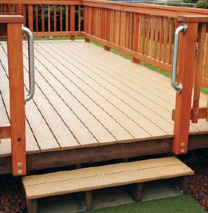

Figure 7. These short stairs don’t require guardrails or a handrail, but two stainless-steel grab bars were quickly installed to provide a stylish assist.
A Gripping Tale
My stairs have just two risers, so they technically don’t need guardrails or a handrail. In fact, with stairs that short, guardrails can be an awkward detail. These stairs, however, will sometimes be used by a woman with Down syndrome, and they can also get icy in winter, so my customers hoped for an elegant alternative. It turned out that one of their neighbors is a commercial contractor, and he happened to have a couple of leftover stainless-steel grab bars on hand. Voil ! I screwed one to each side of the stair opening with stainless steel screws (Figure 7), and my customers are happy.
