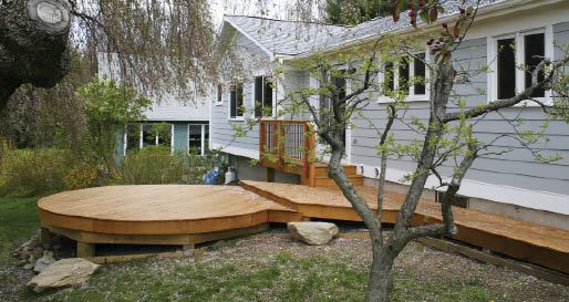

Last summer, my old friend and customer Strother asked me to build him a deck. But there was a catch: He wanted to use local materials. One reason was that materials sourced nearby contain a lot less embodied energy than materials trucked in from afar. Plus, buying them supports the local economy, something I also make a conscious effort to do. Finally, a deck made from local woods has a unique appeal. Where’s the downside?
Well, there are a few. Local materials can be more work. And they can be hard to sell to the building department. And they can be hard to find. It largely depends on where you are.
What Local Woods?
If you’re in the South, local materials might simply mean locally produced and treated southern pine. In the Northwest, you may have locally available Douglas fir, cedar, and redwood. Where I am in Connecticut, though, none of the typical commercial decking woods are locally produced. Even so, some of our local species do have the properties required for decks. Strother, who is a professional woodworker, and I agreed that the relative availability, rot resistance, and appearance of black locust and white oak made them obvious choices.
Black-locust heartwood, for example, doesn’t rot over a human lifetime, and it’s strong, with a modulus of elasticity (and therefore span capability) that exceeds that of Douglas fir and southern pine by a considerable margin. The heartwoods of both black locust and white oak are listed as being nearly as rot resistant as red cedar’s and redwood’s by the USDA’s Forest Products Lab. White oak is also extremely strong; Old Ironsides, the USS Constitution, got its nickname because cannonballs from the HMS Guerriere were reported to have bounced off its white-oak sides during the naval battle between those ships in the War of 1812. Black locust and white oak are tough woods to work, but when green they aren’t too bad. And given that decks are outdoor structures, it hardly seemed worth the extra cost to use dry lumber.
Using white oak would mean I’d have to choose materials carefully, as it looks similar to the more common red and chestnut oaks, which don’t share its rot resistance. Though I wasn’t too concerned about rot: I’m convinced that with careful detailing, which I planned to do as a matter of course, a deck that won’t rot can be built from balsa wood.

Local materials may impose certain limits on your design. The white oak available to me ranged greatly in width, which meant I couldn’t use a standard-width decking. I suggested to Strother that we use random widths instead, and fortunately, he liked the idea very much.
I bought the decking lumber at a sawmill run by a taciturn New Englander named Bob. The mill’s saw is ancient and its safe use seems to depend solely on the operator keeping clear of the moving parts. I once asked how old it was and Bob asked, “Which part?” The day I went to purchase the wood, Bob led me through the mud to a covered stack of rough-sawn white oak that ranged from more than 12 inches wide to about 6 inches wide.
One key to using any naturally rot-resistant wood is that it be all heartwood – sapwood of any species is rot prone. A second key is to work with an honest sawyer. With Bob on one end and me on the other, we dug into the pile. Bob would look each board over, point out sapwood and other defects, then say something like, “Can you get 6 feet out of this?” I’d nod or shake my head no, and we’d toss it on the truck or set it aside. I tried to keep track of board footage but lost count within minutes. At one point I asked Bob, and he said something like, “About 173 feet there now.” I gave up and trusted him – a good decision, as I ended up with about 20 percent more usable wood than I paid for.

Job Cost
I don’t know exactly what the economics of using local wood turned out to be. There was definitely a lot more labor, but because of the deck’s complicated geometry, it’s hard to say just what cost what. I quoted $15,000 for the project. Retrospectively, that should have been closer to $18,000. I’ll assign half of the difference to the lumber, and the rest to the geometry. There’s not a lot I would do differently, except I might buy the lumber planed and ripped. I’d end up throwing away more sapwood, but I think the time savings would make up for that.
