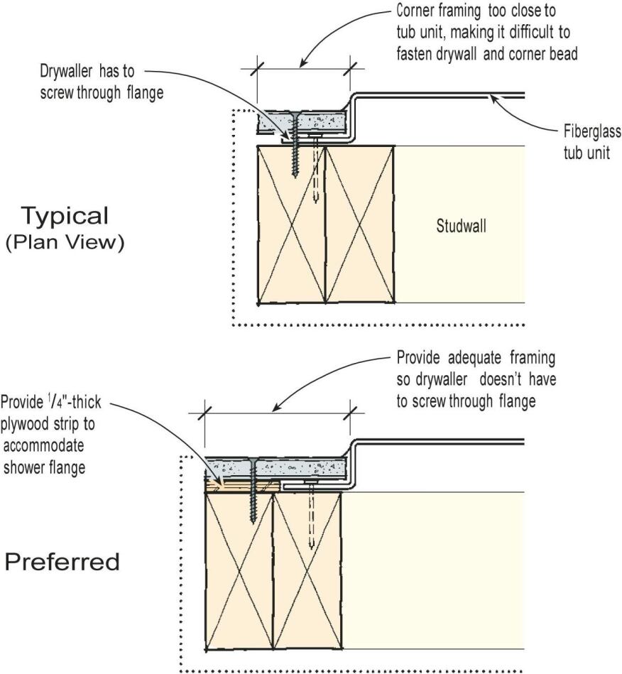

Four Problem Areas F
our common details- at tub/shower units; at fire blocking locations; at inside corners; an near joist hangers – are shown in the illustrations below. Pay close attention to these to avoid drywall problems.
2) Or you can use specialty PVC drywall trim, such as the Shower Bead, which bridges the gap created by the flange and provides a clean, finished edge against the tub/shower unit.

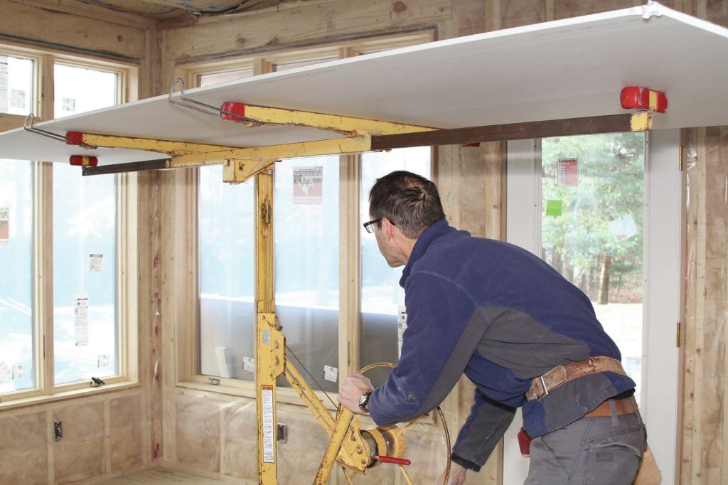

Advantages of a lift. A drywall lift is an efficient way to hang ceilings. (Lifts can be rented.) It supports the sheet tight against the joists while the screws are being driven, thus reducing the chance of fastener pops.

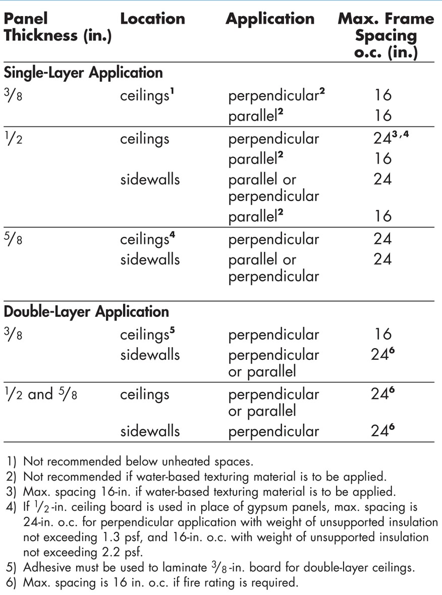

Panel direction and frame spacing. Drywall panels of different thickness will span the framing spacings indicated in the table. “Application” refers to the direction of the long edge relative to the framing members.

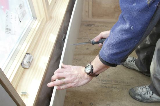

Keep it short. Undercutting the length by about ¼ inch will leave space for out-of-plumb framing. Trying to jam a too-tight piece in will bust it, leaving a big repair to deal with.

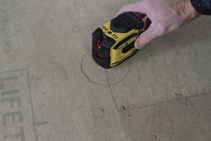

Use a small laser to project a dot on the ceiling to find the box location for the router plunge.

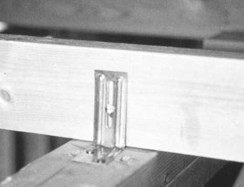

Compensating for Truss Uplift
Instead of nailing trusses to wall plates, use truss clips as shown. The clips allow each truss to flex up and down freely, while preventing it from moving from side to side.

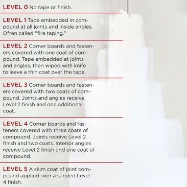

Specifying finish level. The drywall finish level should be specified to match the lighting conditions and the type of decorative coating that will be used over the drywall. Higher levels of finish are required with glossy paints, thin wall coverings, and critical lighting angles.
