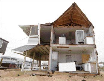

When the big one blows through, it’ll be the windows and doors that keep the house upright Imagine a house on the beach facing sustained winds of more than 75 mph and periodic gusts reaching above 120 mph. As long as the house remains intact, these hurricane-strength winds will blast the ocean side of the house with pressures measuring over 40 psf. As the winds rise over the rooftop and rush around corners, suction pressures in the wake of the blast will exert even greater pressures on the sides and back of the house. These pressures will reach their peak — as high as 75 psf of suction — at the building’s corners, eaves, and ridges, where the wind causes wild fluctuations in pressure that push and tug erratically at cladding and roof coverings.
That’s if the house stays intact. Now imagine these winds ripping out the neighbor’s fence and hurling it through a window or patio door. “Once you breach the envelope, the air rushing in pressurizes the building just like blowing up a balloon,” explains Scott Schiff, a civil engineering professor and director of Clemson University’s Wind Load Test Facility. Now you have positive pressure pushing from inside and negative pressure pulling from outside. In the best case, these pressures will blow out all the other windows in the house, equalizing the pressure before severe structural damage can occur. More disastrous (and likely if the house was poorly framed), the entire trussed roof assembly or whole wall sections blow out. “The house literally explodes,” says Schiff. “If it doesn’t actually come apart, it’s drenched by all the wet air racing through the interior.”

Winds whipped up by Hurricane Isabel came rushing in the ocean-side windows and doors of this North Carolina home, pressurizing the interior until the entire back wall blew off. (Photo by Vince Lupo).
