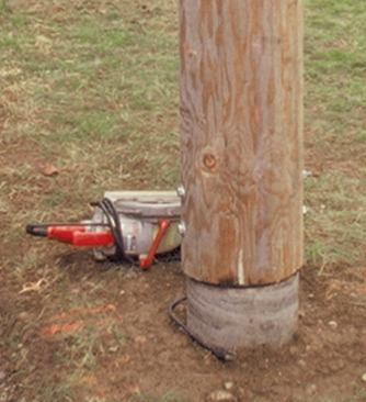

Regardless of the size of the footing where it bears on the ground, the top of the concrete — which I call the pedestal — needs to be 1 inch to 2 inches smaller than the bottom of the log post. This provides a drip edge around the bottom of the log, helping to keep water from running underneath the bottom of the posts. To prevent water from splashing onto the base of the log or wicking up from the ground, I keep the top of the pedestal at least 6 inches above grade.

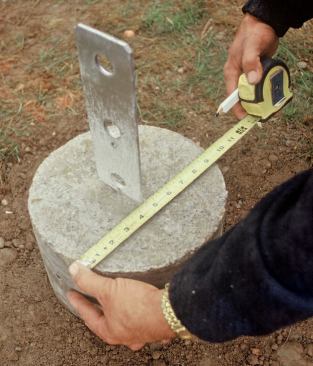

To form a hold-down for the post, I embed a Simpson HD-10A about 10 inches into the pedestal, leaving 8 inches of the anchor protruding. This will be fitted into a slot cut into the log with a chain saw, forming a blind connection that’s more visually appealing than an exposed hold-down.

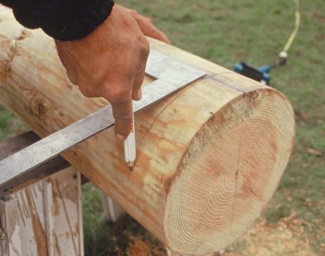

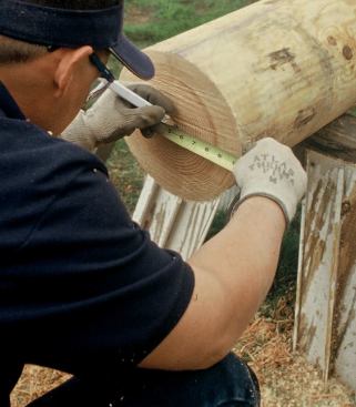

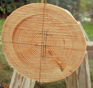

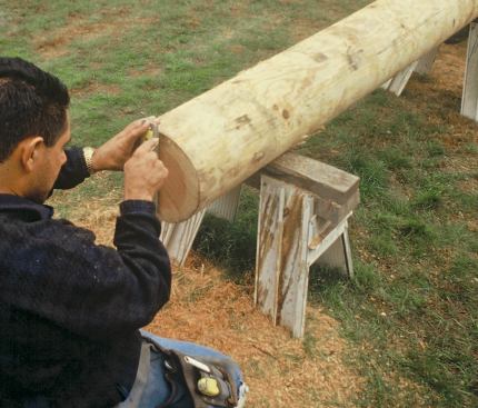

For either design, it’s important to cut the log ends square — a tricky proposition when working with natural logs. To do this, you first find the center of the log’s end by measuring three ways: horizontally, vertically, and diagonally. For each measurement, mark the center. You’ll usually end up with a triangle of dots; the center of this triangle is what you’ll use as the center point. Repeat this at the other end.

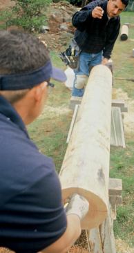

Next, with the log braced against rolling, use a level and a pencil to draw a plumb line up from the center point to the top edge of the log. Again, do this at both ends. Then, using a chalk line filled with white or blue chalk (which won’t leave a permanent mark), snap a line down the length of the log connecting the top points of the two plumb lines. I call this the layout line.
Place the long side of a framing square against the layout line and draw a perpendicular line 2 inches from one end of the log. Some eyeballing will be required. Finally, use a chain saw with a sharp chain to cut the log.

After making the cut, I check for square at several points. Tapered logs require some approximation. Assuming a fairly uniform taper, find the difference between the diameter at the end of the log and that at the far end of the square, 24 inches from the end of the log. Half this difference is the size of the gap you should see between the end of the square and the log as you check the cut.

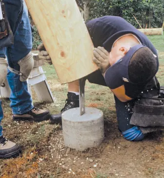

Cutting the slot for the HD-10A requires another layout at the bottom end. Using the chalked layout line and a level, draw a vertical line on the log’s end, then measure down this line to find the center of the log. Next, measure where the HD-10A protrudes in relation to the center of the pedestal and transfer that location to the base of the log, so that the log will be centered.
Plunge cutting with a chain saw takes a little practice and a lot of caution. If you contact the log with the top of the chain saw’s bar, the saw will kick back. I typically start a plunge cut with the saw at a 45-degree angle to the bottom of the log and in line with its length (see “Safe Plunge Cuts,” below). As I start the cut, I gradually raise the chain-saw bar to horizontal while applying downward pressure and pushing the bar forward into the log. If you don’t apply continuous downward pressure, the bar will jerk violently upward. You need to go in only about 2 inches deeper than the height of the HD-10A.
