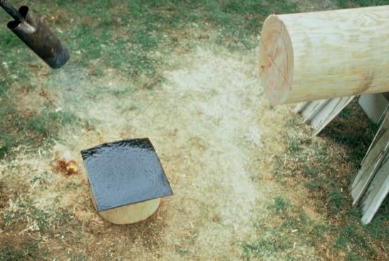

As protection against water wicking up from below, I seal the bottom end of the log with torch-down roofing. To do this, use a torch to heat a piece of roofing material that’s slightly larger than the base of the log. Then, while wearing gloves, adhere the hot membrane to the bottom of the log. When it cools, trim it with a utility knife to match the bottom of the log and slit it at the plunge cut.

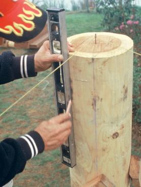

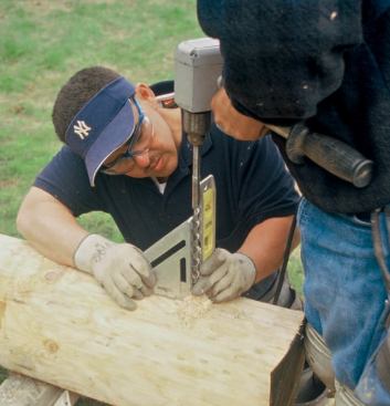

The log post attaches to the HD-10A with 5/8-inch-diameter through-bolts, so the next challenge is to drill the bolt holes. First I use a level to orient the log so that the plunge cut is horizontal. Then, using the same technique as before, I draw a plumb line from the center of the plunge cut to the upward face of the log. I draw a matching line on the other end of the log and snap a new line down its length. The bolt holes fall on this line. I measure the heights of the holes in the HD-10A and transfer the measurements to the new chalk line.

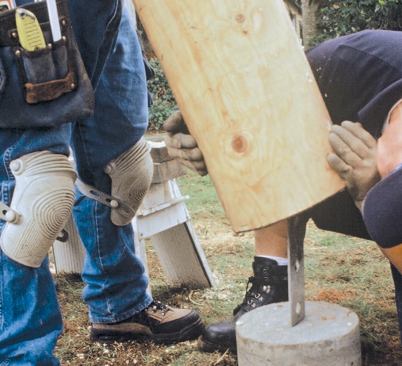

The next step takes two people. One carpenter drills the hole while the other guides the 11/16-inch auger bit with a layout square and a torpedo level. After the holes are drilled, we slip the log over the HD-10A to make sure they align. The bolts should be about 1 inch longer than the diameter of the log so there’s room for the nut and washer. We plumb the post and brace it from two directions.

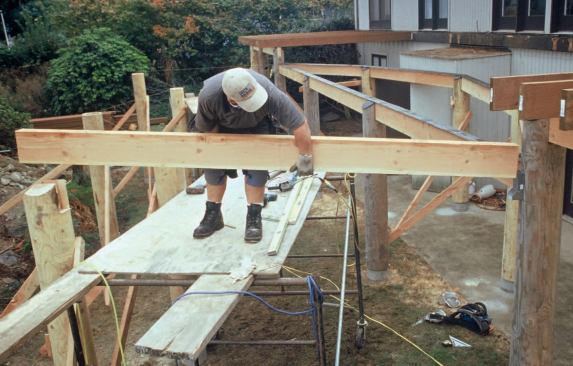

Pocket cuts require two parallel cuts for the sides and a plunge cut at the bottom. To be safe, we work from scaffolding, first running a string line from post to post down the length of the deck to represent one side of the beam. We mark that side on the tops of the posts, then measure to mark the other side. From these lines, we draw plumb lines down the sides of the posts, mark the bottom, and use the chain saw to cut the pocket.
Blind pockets are laid out and cut in much the same way, but the side cuts and the bottom plunge cut don’t go all the way through. Also, you’ll need to make a blind cut from above to end the pocket.
After test fitting the beam in the pocket, it’s a good idea to bevel the remaining flat parts of the log’s top to shed water. I fasten the beam to the pocket using FastenMaster’s LedgerLok screws. You could also use bolts or lags.
If the beams sit on top of the posts, I attach them with 4-inch-long pieces of 4-inch-by-1/4-inch powder-coated angle iron with two holes on each leg for lag screws. The angle brackets attach to the bottom side of the beam and to the side of the post to transfer lateral loads. (All these connections are engineered.)

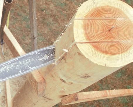

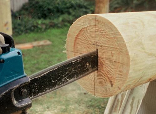

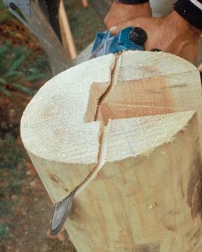

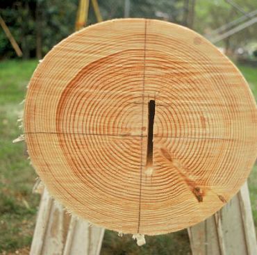

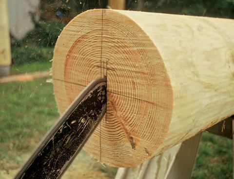

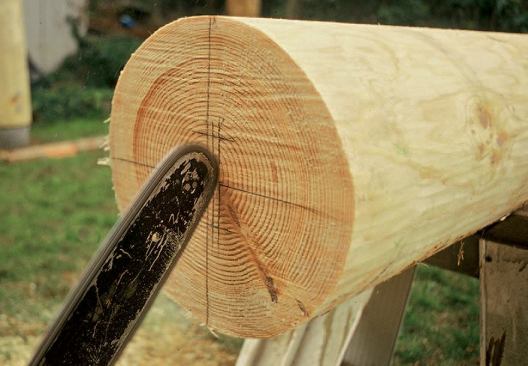

Safe Plunge Cuts
Plunge cutting with a chain saw requires caution. If the top of the bar contacts anything while the chain is spinning, it will kick back at the operator, which could result in a serious injury.
Start the cut with the bar at 45 degrees to the base of the log and the bottom of the bar tip contacting the wood. While maintaining downward pressure to avoid kickback, slowly raise the saw as you push in. Keep pushing down and inward, stopping the plunge when its about 2 inches deeper than the height of the anchor. The finished cut shouldn’t be much higher than the width of the bar.
