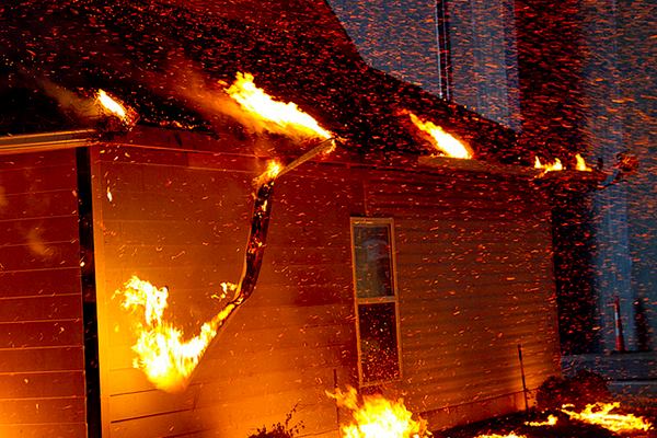

Builders, roofers and deck contractors have a huge influence on reducing the risk of a building fire. According to the Insurance Institute for Business and Home Safety (IBHS) windborne embers present the greatest problem, particularly when they get sucked into roof vents, and caught in corners where dried leaves and other combustible debris collects. At it research center, IBHS conducted full-scale “ember testing” on home mock-ups. The testing is summarized in this youtube video that’s well worth watching, and the results have helped IBHS refine its guidance on wildfire-resistant homes (see the page of Wildfire at disastersafety.org)
