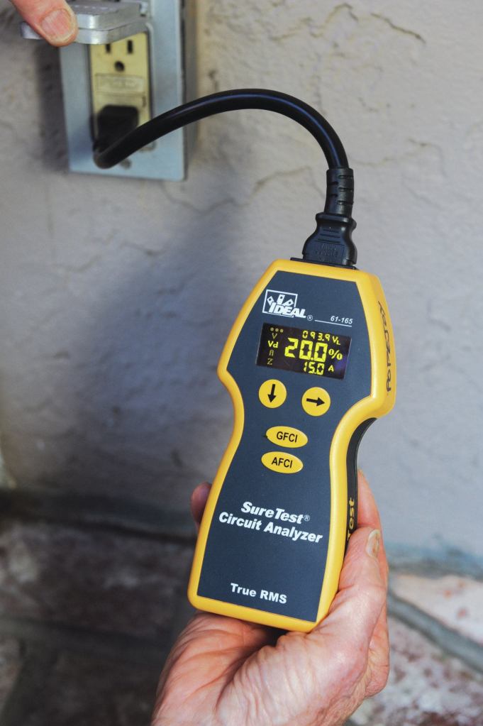

This electrical meter measures voltage drop that can occur from bad connections or splices.

What I’d be more concerned about with the 16-gauge ground wire is whether the connections (“splices,” in electrician-speak) in the ground wire are all good. Every circuit that serves receptacles and lights is made up of segments of wire (inside cable in most houses) that run from box to box. And in each box the grounds are spliced together (as are the hot and the neutral wires).
With a hot wire or a neutral wire, a bad splice can give users some warning before it fails by causing flickering lights, a buzzing noise, or a burning smell. But the ground wire is different because it only carries current when there’s a ground fault. A bad splice in the ground wire keeps it from carrying the fault current adequately, so the breaker won’t trip as quickly as it is designed to, which can lead to a fire.
To check the condition of the circuit, you need a specialized tester that measures voltage drop in the circuit when a controlled load is applied. Running a voltage-drop test will tell you the condition of the wiring and the integrity of the splices without having to open every box in the house to check the connections. Plus, the tester can tell you if there are bad splices that you can’t see, such as in a hidden junction box, or worse, not in any box at all. These testers are expensive, but a good service electrician who does troubleshooting and repair work should have one and should also have enough experience to interpret the results of the test.
