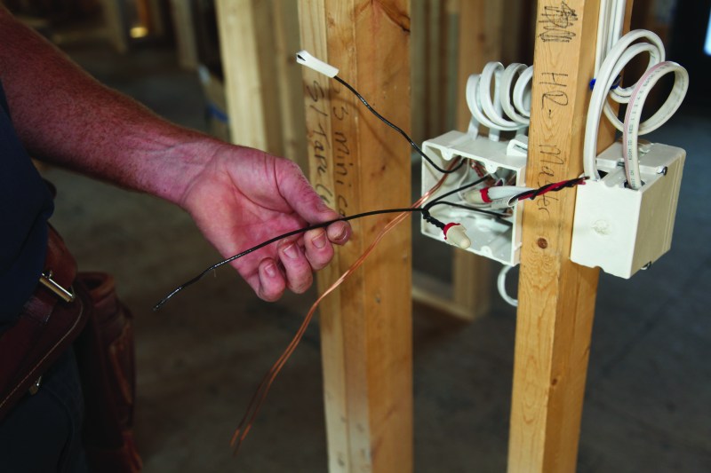

In multiwire branch circuits, more than one circuit coming from the main electrical panel shares the same neutral conductor, such as when 3-wire cable runs from the panel with the black conductor and red conductor controlled by a two-pole breaker while using the same white (neutral) conductor. The code says that when you are using one neutral to serve two separate 120v circuits, you have to junction and pigtail the neutral at each device. That way, if you remove the device, you don’t accidentally disconnect the neutral that is also serving the second circuit.

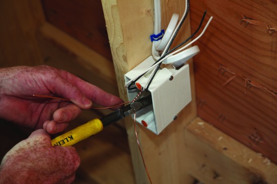

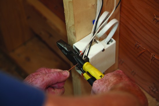

The code requires that all ground conductors be connected  so that the continuity of the ground is not interrupted if the  device is removed. This requires a pigtail, but making a pigtail  for ground conductors requires a specific approach: First,  twist the bare ground conductors together for several turns,  and then cut off all but one for each device in the electrical box.
In another example, section 250.148b in the code states: “The arrangement of grounding connections (the bare ground wires) shall be such that the disconnection or removal of a receptacle, luminaire, or other device fed from the box does not interfere with or interrupt the grounding continuity.” This means that ground conductors should always be pigtailed so that removing a receptacle or switch does not disconnect the ground to the rest of the circuit. When pigtailing the grounds in new construction, I twist all of them together with several turns and then cut off all but one for each device in the box. I then secure the ground junction with a copper crimping sleeve.
To secure the junction, slide a copper sleeve onto the twisted conductors and crimp the junction with pliers
