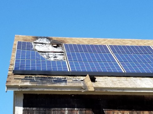

Panic flooded my whole being. I ran into the studio and grabbed my laptops and a few valuables. The smell of smoke was already coming into my office area. I ran into my neighbor’s yard (the only place you can see the roof) and saw that the fire was coming from my solar panels, and it appeared that the roof shingles under the panels were on fire. I ran to the front of the building and hit the shut off for the array. I also ran inside the building and turned off the main electrical breaker.

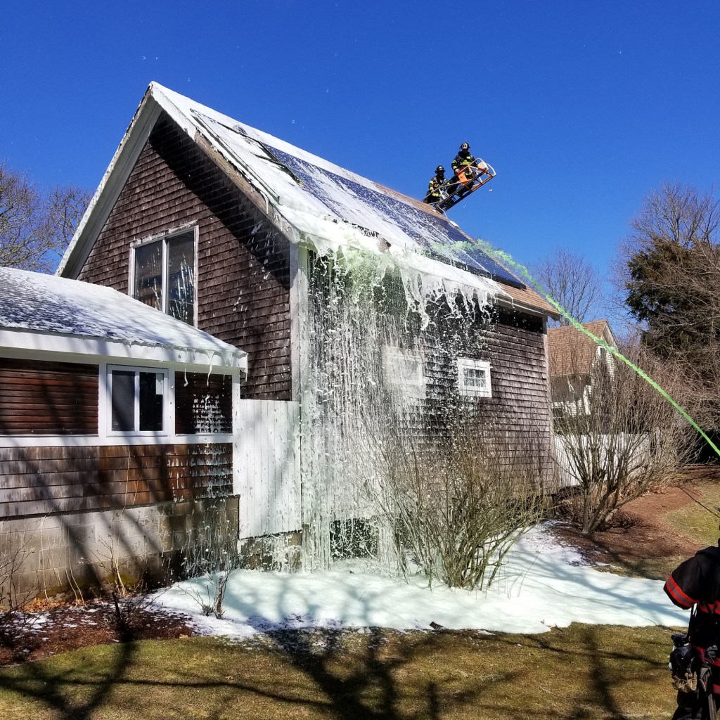

The police and fire department got there almost immediately. The firefighters ran their hose from the truck and into the neighbor’s yard. When the water from the hose hit the burning panels, glass exploded everywhere. The water jet peeled back the shingles and the fire persisted for a short while. While that group of firefighters handled the hose, the ladder truck arrived and another group climbed the extended ladder up over the peak of the roof. The flames had subsided but smoke and steam continued to billow from the damaged area.
I accompanied one of the senior members of the firefighter crew into the building and showed him the pull-down access to the attic space just below the roof. He climbed the ladder and confirmed that despite the heavy smoke in the attic, the fire had been confined to the exterior roof.
Back outside, the same gentleman came around the side of the building with an IR camera, aiming it at the various spots on the roof and reporting on the temperature readings. With the charred area still steaming and smoking, they made the decision to foam the roof. In any other situation, the scene would have been comical. Thick, green foam covered the entire roof cascading down the wall and onto the grass like some sort of St Patrick’s Day dessert topping. But the foam did the trick, and when the IR camera readings were all down to safe levels, the firefighters rolled up their hoses and were quickly on their way.

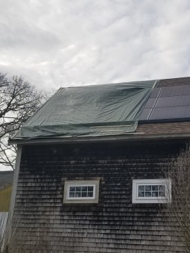

It was now late Friday afternoon with 100% chance of rain predicted in two days and my studio roof still wide open. All that the gentleman at Tesla could tell me was that my case was “under review,” apparently oblivious to the fact that my charred roof was open to the elements. Saturday, I took matters into my own hands and hired a contractor to stretch a tarp over the damaged roof as a temporary cover.

Everyone I’ve spoken to has expressed surprise that a fire could have started in the solar panels. A friend who was formerly a salesperson for Tesla said that because my system was leased, Tesla would be totally responsible for any damages both to the array as well as to the building where the array was mounted. Tesla’s lack of response and compassion makes me believe that it will be a long slog to have it assume any sort of responsibility.
Back when I had the system installed (Renting the Sun, April 2014), Solar City was putting in a lot of systems all over the Cape, so it makes me wonder if there are ticking time bombs on any other roofs? In retrospect, I regret not having my solar array installed and maintained by a local company. My guess is that a local company would be doing a lot more to see that the problem is taken care of. The system had been performing flawlessly for almost five years, but given this scary scenario, I’m left questioning my decision to “go solar” in the first place.
