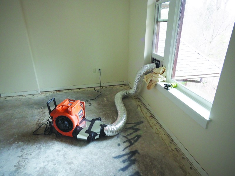

Research has demonstrated COVID-19 can be spread through aerosol transmission and can attach to larger particles, such as those that may comprise construction dust. Hayward Score said such risks make it important to increase ventilation to greater than 5 air changes per hour and improve dust removal methods.
Ventilation can be achieved through measures that put the workspace under negative pressure and provide effective separation between the workspace and occupied areas of teh building. In some case, cracking a window and adding a fan ducted to the outside in each room of the work site will work. In other cases, high-grade air scubbers with HEPA-filters may be needed to provide adequate negative pressure and filtration. Also HEPA-filtered jobsite vacuums should be used frequently to help minimize dust. According to Hayward Score, brooms and standard vacuums should not be used because they only recirculate particles rather than removing them.
