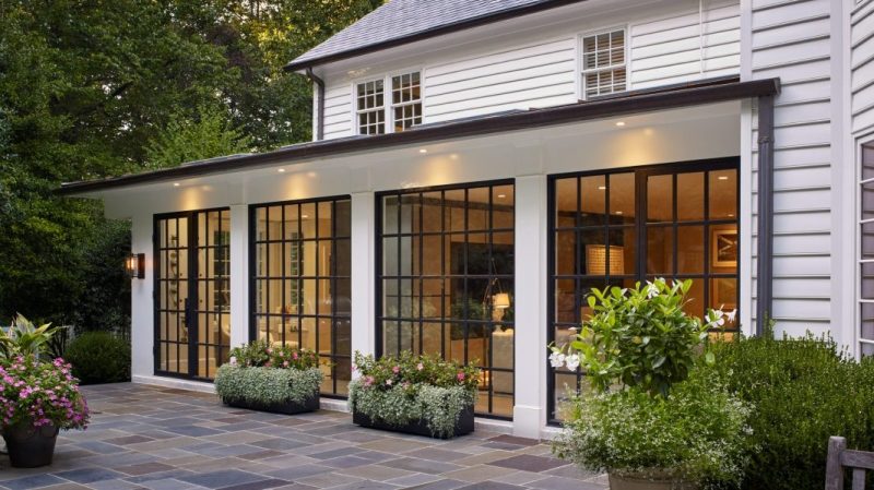

Photo by Nova Soul Imagery
A house in Great Falls, Va., remodel by BOWA.
