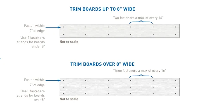

1. Fasten it right. “Use Cortex fastening screws [when installing PVC trim],” Davis says. “Cortex plugs aren’t obvious if you’re consistent with placement, not haphazard. Depending on the board size, install every 12 inches and make sure the screws line up vertically. I do two screws, one-inch from the bottom and top. Three screws on bigger boards. Cortex eliminates movement.”
2. Fasten often. “Every single nail holding PVC siding is into a stud, just like all my trim. I have solid attachments everywhere. I use a lot of fasteners and lots of glue. If you think you’re doing enough, you’re probably not. You need to do more,” Davis advises. The reward? No siding movement from season to season, even in Maine (where you have big temp changes).

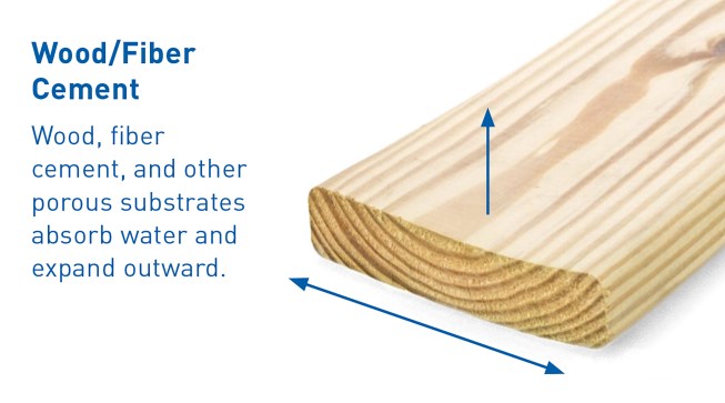

3. Fasten near the edges. Wood and cement board can splinter or crack if fastened near the edge. Free foam cellular PVC is different. You fasten PVC near the edges to prevent buckling and warping, Davis says.
4. Keep it cool. Keep stored PVC siding, trim, molding, or other PVC products out of the sun. Store in a garage or under a lumber tarp. Cool PVC installs truer. Davis knows all material moves, whether it’s wood, fiber cement, or PVC. “If installed right, it’s set-and-forget with PVC. That’s the beauty of it. Just follow the manufacturer’s guidelines,” Davis says. “There’s no expansion and contraction from water absorption. Sealing, painting, repainting, maintenance and all the things you normally face with wood go away with PVC. Just fasten properly.”

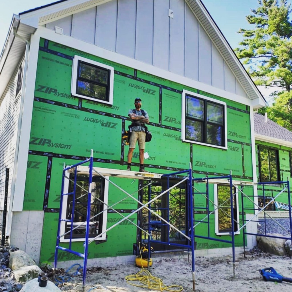

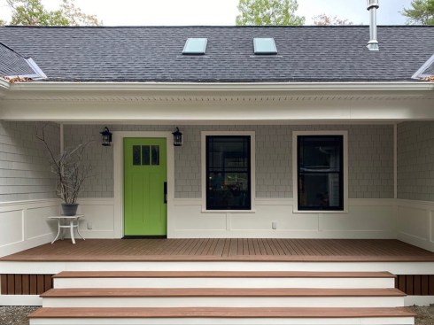

As proof, Davis points to his own home. He relied exclusively on PVC trim, molding, and siding from his go-to PVC building material supplier, AZEK.
“I want the look of wood, not the maintenance,” he says. “It’s all about set-and-forget. No repainting. No color fading. No peeling, warping, rot, or having to add a rain screen.”
