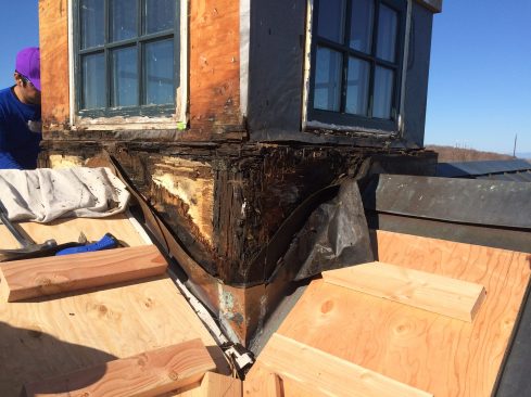

Both white and brown rot can grow in the same piece of wood - in this case, the sheathing around a poorly flashed cupola.
Isaias Antonio-Santos

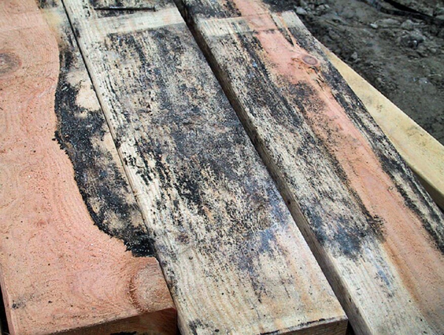

Called in to address an attic mold problem, the author was confronted with more mold than just what was growing on the roof sheathing. The owners liked to keep indoor temps high (around 78° F) and ran six humidifiers all night, creating a jungle-like environment rampant with interior mold.
Nate Adams
Not rot. Mold is undesirable on wood surfaces in a home for a number of reasons, but it does not affect the structural characteristics of wood.

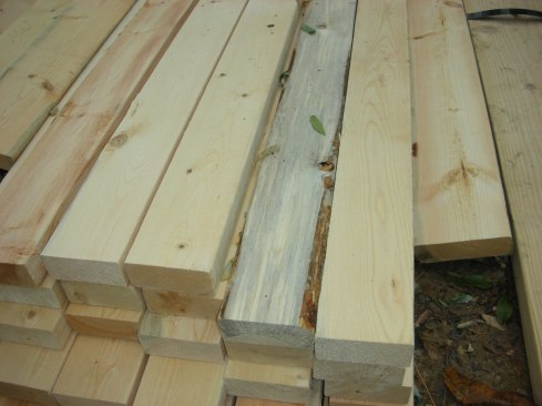

Steve Easley
Not rot or mold. Blue stain is caused by a fungus that lives in the sapwood of trees. It causes bluish or grayish discoloration of the wood but does not cause decay, and the stain has no effect on the strength of the wood.
Similarly, blue stain is caused by microscopic fungi that commonly infect the sapwood of living trees; the fungi remain in the wood when the tree is milled into lumber but cause no loss in strength. Decay fungi, on the other hand, break down the cellular structure of wood, which does cause a loss of strength.
Both white and brown rot can grow in the same piece of wood – in this case, the sheathing around a poorly flashed cupola.

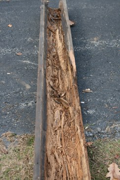

"Dry" rot. Rotten wood is often found in a dry condition and so is called "dry rot." But the wood had to have once been wet for the decay to occur. In this case - an old wood gutter - the wood had ample opportunity to get wet. (For details on how this gutter was replaced with respectful consideration to the original building details as well as long-term future performance, see "Replacing a Wooden Gutter.")
Kyle Diamond
"Dry" rot. Rotten wood is often found in a dry condition and so is called "dry rot." But the wood had to have once been wet for the decay to occur. In this case – an old wood gutter – the wood had ample opportunity to get wet. (For details on how this gutter was replaced with respectful consideration to the original building details as well as long-term future performance, see "Replacing a Wooden Gutter.")
Dry rot is a term loosely applied to any dry, crumbly rot, and especially when, in an advanced stage, the rot can be crushed easily to a dry powder. The term is a misnomer for any rot-induced decay, though, since all fungi require considerable moisture for growth.

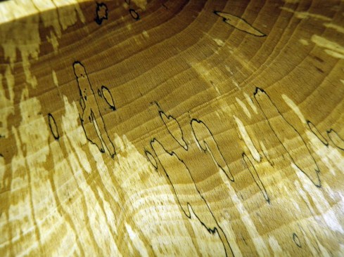

Zone-line decay, a.k.a. spalted wood, can be used for trim work as long as the wood is firm and doesn't have pockets that are punky.
Bernhard Hofmann
Zone-line decay, or spalted wood, can be used for trim work as long as the wood is firm and doesn't have pockets that are punky.
Spalting is caused by certain types of white-rot fungi growing in wood (primarily hardwoods such as maple, birch, and beech). The fungi create “zone lines” in the wood where territories of competing fungi meet (see photo at right). Though usually used for decorative woodwork and furniture (live-edge tables and shelves are currently in vogue), spalted wood is occasionally used for interior trim, as well. According to the Forest Products Laboratory, once the wood is harvested, the fungi die and remain in stasis without further growth or compromise to the wood. (It is also possible to actually induce spalting in harvested wood; see the Forest Products Laboratory’s technical bulletin “Producing Spalted Wood.”)

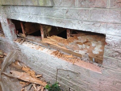

Not all deteriorated wood is caused by rot, though. Termite damage often looks exactly like “dry rot.” And in many cases, the scent of rot may be what drew the termites. But termites usually are a lot quicker than fungi at destroying the structural integrity of a wood structure.
Things are not always what they seem. Water seeping through brick got things started here, and you can see where the fibrous mat of white rot lingers on the surface of this rim joist. But the ultimate destruction of this framing came from termites. Termites primarily search for food by the scent of wet, rotten wood, so the onset of rot certainly contributed to this structure's demise.
Robert Mignogna

No question. In cases of advanced decay, as on this cupola , there is little question that the rotted structure needs to be completely replaced with new framing (and the flashing details worked out to prevent this from happening again; to learn more about this project, see "Fixing a Poorly Flashed Cupola").

Mold on Lumber
As mentioned at the beginning of this article, mold growth on lumber has no structural effect on wood. Unlike rot fungi, mold fungi grow only on the surface of lumber and do not have roots that grow deep between the wood fibers. When you find mold on lumber in the lumberyard or after storing lumber on site (black is most common but it can also appear green, pink, or orange, among other colors), it should be avoided or cleaned off.
Typically, mold on lumber is an indication of high moisture levels in the wood, and the lumber needs to be dried to a moisture content below 22% before using it to frame a wall. (And dry below 19% before closing it in; some folks will even say below 12% before hanging drywall if they are concerned about interior wood joints staying tight.)
A mold stain may remain on the surface of lumber after lumber is dry, and once encased in the wall is unlikely to be a problem … except that it can be. There is limited research that “hidden” mold can increase the amount of mold spores in the indoor air, but mold is one of those hair-trigger issues that is best to avoid if you can. If owners are walking the site and see mold on lumber, it will raise concerns, and concern easily escalates into fear and litigation. To avoid all that, it’s best to not select it at the lumberyard to begin with. If it’s delivered and can’t be returned, or is discovered after it’s on site, it’s best to clean off the mold before building with it.
To clean mold from the surface of lumber, scrub with water and detergent, then rinse and wet vacuum the surface. The individuals doing this work should wear gloves, eye protection, and NIOSH-approved respirators. Do not use bleach. Bleach may help remove the mold stain, but it won’t remove mold spores and is a lung and skin irritant. Using bleach only unnecessarily exposes workers to a hazard. Detergent will do as well to remove the stain, and what will really get rid of the spores is vigorous scrubbing, rinsing, and vacuuming. If the mold is caused by a flood contaminated with black water, use an EPA-registered disinfectant. These tend to have fewer adverse effects on workers than bleach, but you still need to follow safety guidelines for protecting workers.
