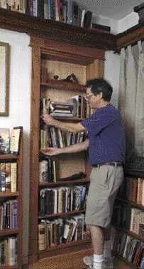

Hidden-door bookcases aren’t easy to design or build, but they’re always an intriguing undertaking. Every time I build one, I learn something new. I still haven’t achieved the perfect unit, with a completely invisible door that works smooth as silk for years to come — not even the one shown on these pages.
In this article, I’ll point out a few of the mistakes I’ve made, so that you don’t repeat them.

Given my past experiences, I’ve concluded that the best way to build a durable swing-out bookcase door — one that can be adjusted easily and is truly invisible — is to design it to swing above the baseboard and mount it on a center-hung pivot hinge.
Start With a Drawing
For this project I used SketchUp to find the correct location for the pivot point, which took some experimenting. The program allows users to draw an assembly and pivot it about a specified point.
Notice in the illustration how the door, when wide open, butts against the trim on the hinge side. That clearance is determined by the depth of the bookcase and the location of the pivot measured from the hinge jamb toward the strike jamb.
I also wanted the case to have a minimal amount of clearance between the jambs, so it would just clear the trim on the hinge side and wouldn’t require wide trim on the strike side. That clearance is determined by the setback of the pivot from the face of the wall.
Bottom Clearance
A big improvement in the design shown here is that the bookcase swings above the baseboard. This means it won’t drag on a throw rug and can be trimmed out without any visible gaps.
I wanted the case to end up about 2 3/4 inches above the floor, to clear 2 1/2-inch baseboard. My drawing confirmed that mounting the pivot base on two layers of 3/4-inch plywood would get me close to 2 1/2 inches above the floor. Because I could install the toekick after swinging the case, the exact dimension didn’t matter, which made installation a lot easier.
